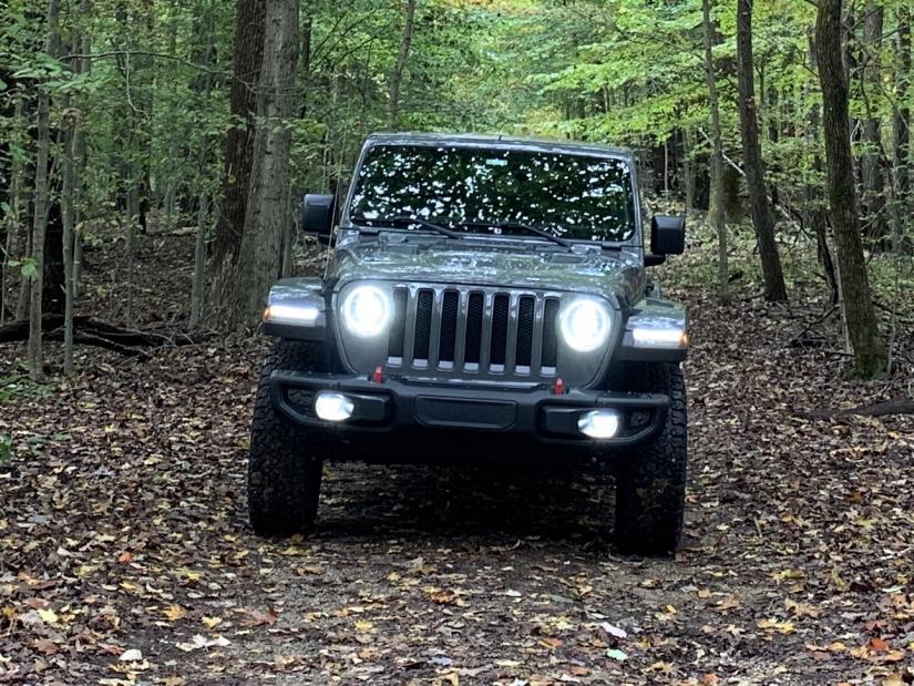

I find most LEDs, even the OEM ones on the obnoxious side of the automotive lighting scale. Here's my Jeep in an overcast daylight pic with the LED low-beams, fogs, and LED parking lights on.
