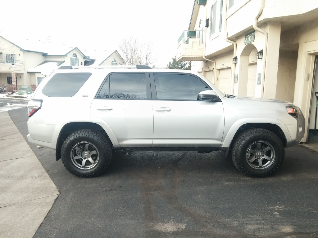

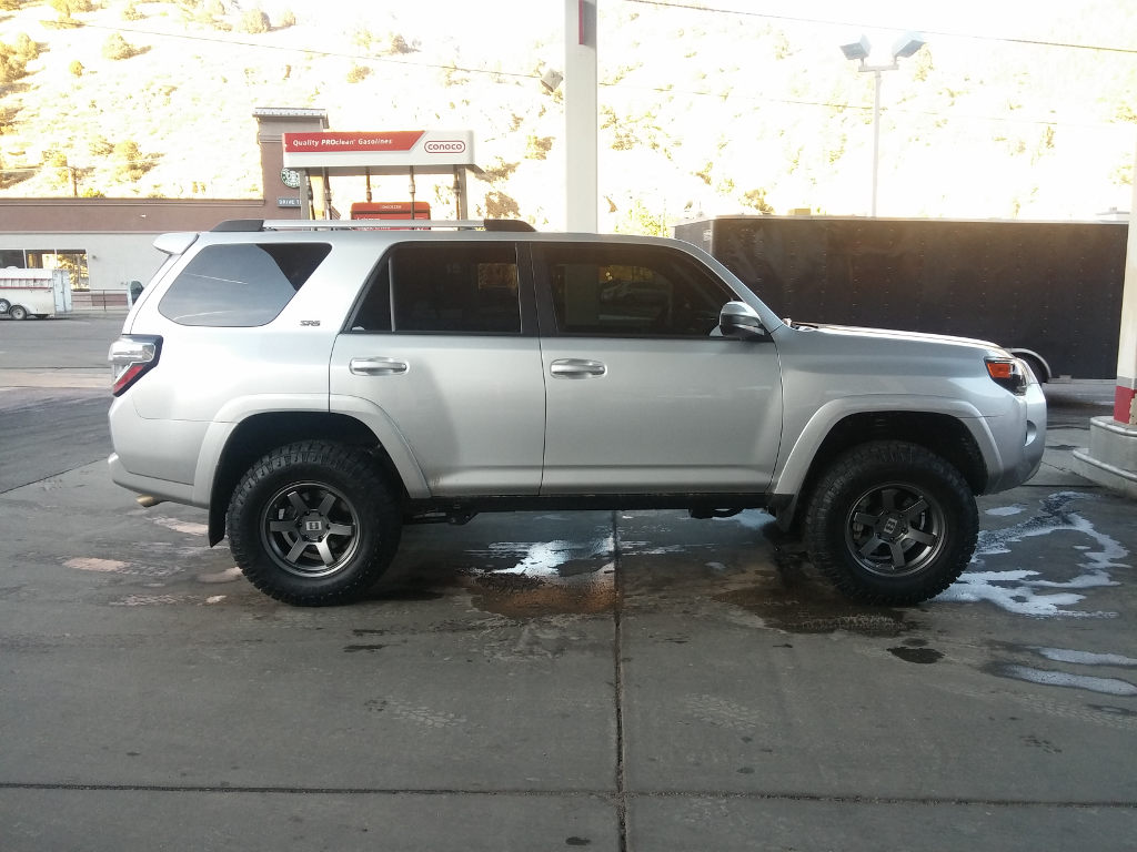

I did the adjustable 5100's in front set at 0" with Toytec 112620 springs and a 1/4" top plate spacer on the drivers side. On a 5th gen those springs add about 1.75" of lift and have a higher spring rate than the stockers which helped tremendously with brake dive and also provided slightly less lift than using the bilsteins on 1.75" which are known to actually give about 2".
With just that setup (rear completely stock) the truck was PERFECTLY level measuring from the ground to the top of the wheel wells. The issue was that the driver's side was about 1/2" lower than the passenger side with 1/2 tank of gas. So when I put the non-adjustable 5100's in the rear I added a 1" Cornfed spacer to the DRIVER SIDE ONLY, which actually lifts the passenger side a tiny bit as well, and now I have a very slight rake on both sides and nearly a level truck from side to side. I think it rides VERY well, provided a very nice improvement to the stance, and it fits stock size duratracs with the aggressive offset MK8 rims with no rubbing. I'm sure with stock rims you could easily fit 275's and probably 285's with a tiny bit of adjustment.
Bear in mind, even with this minimal lift the alignment (very reputable shop who does a lot of lifted vehicles) was only able to get about 2.1 and 2.4 degrees of caster, so anything higher I have to think will require UCA's. I think it drives great so I'm good with where it's at.
Here are pics before and then with the front lifted but not the rear 5100's and spacer. Looks the same now with a very tiny bit more height in back - about 1/2" rake.
