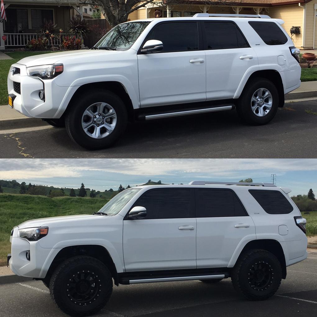

1" rear Cornfed's with front biltsteins @ 1.75 with spidertrax spacers handle as near perfect I could ask of my DD. May go up a bit once I get new shoes but even with stock tires the ride is nice with my setup. Toyota should have made them all this way from factory. Imo

I actually haven't installed the rear biltsteins yet. The 1" cornfeds havent "bottomed out" on the stock shocks at all. Course I haven't been doing any off-road either. I'll change them eventually. For now no need with the new stock shocks on and rides great. Spidertrax really give you that planted feeling on the road

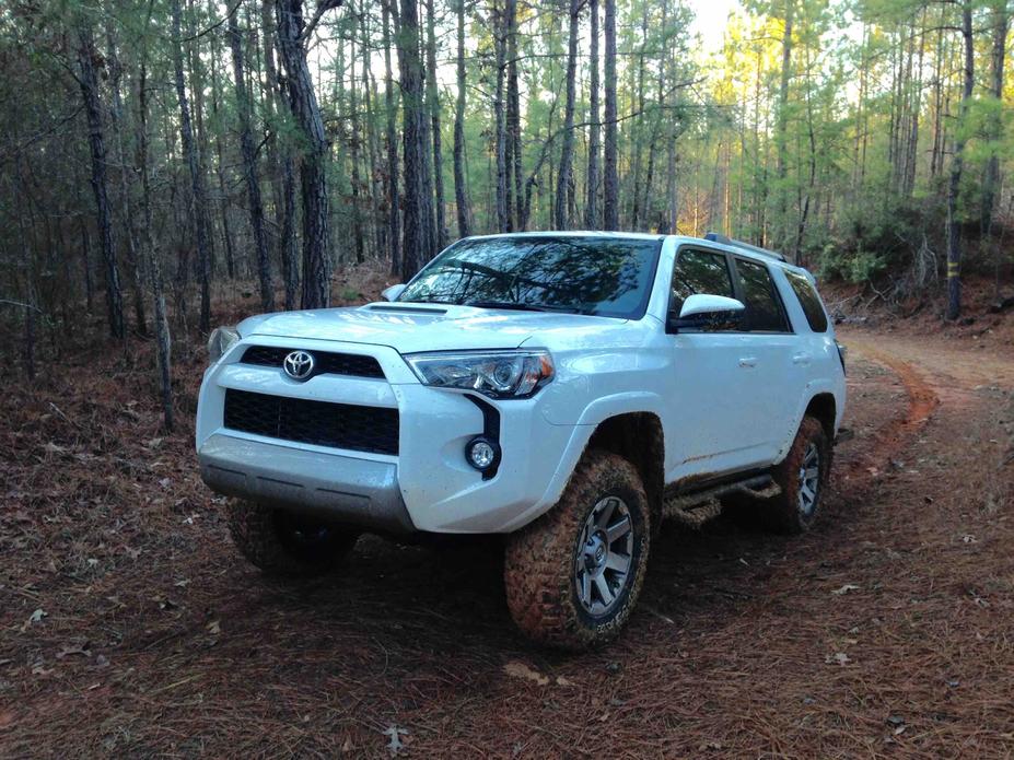

But the dog damn sure hunts. Over 99% of my driving is city and highway. I bought the T4R to get to my property which is a 840 mile round trip. My set -up is listed below and the ride is better than stock in my opinion. I went with a 2.0" Cornfed in the rear because of all the gear I carry when I go to the woods. I believe the UCAs are a must if you're going 2.5 or more up front. Good luck Brother.

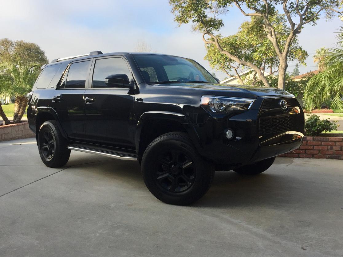

This is mine with the Readylift 3". It's more like 1" rear/2.5" front but it rides great, provides the look I want and did not require UCAs. This is sitting on 285/70R17 rubber
