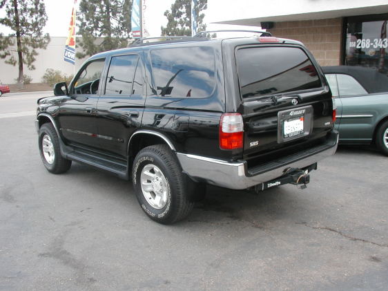

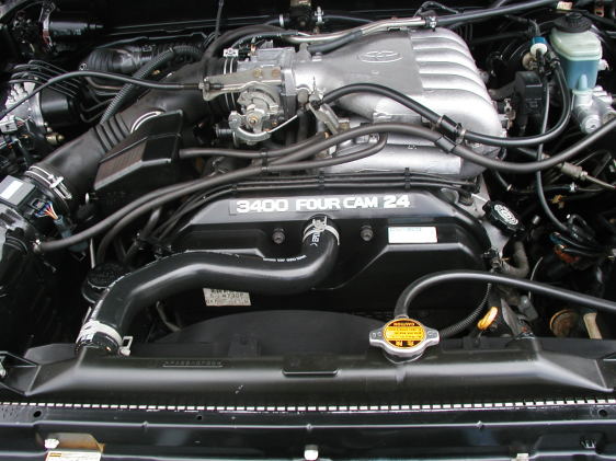

draperyl said:
Dont get much cleaner than this
WOW! i wish my engine was as clean as that! i don't even go offroad yet my engine is soo dusty. but your 4runner looks almost exactly like mine but mine is a gold edition and yours is silver. plus, my fender trim is black and not chrome. but yes, you should get a supercharger if you think it's worth it and feel the need for speed.

Engine Brite
Yeah that gunk stuff has always worked on cars that I have owned. Im sure the pic above of mine wont look like that for 2 long... They had that thing detailed to the max not even any grease or gunk on the block anywhere!
I had to login just to reply to this pic =P Dude, the engine that came with my 2001 SR5 4runner was this clean exactly, 42 days after buying it find out my rings and valves were fried and had to replace the engine with one that looked 6 times nastier than this. Runs perfect and flawlessly with an UUUUUGly engine now LOLOL
