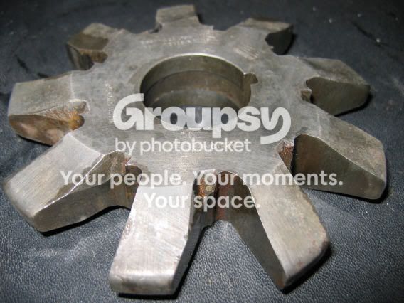

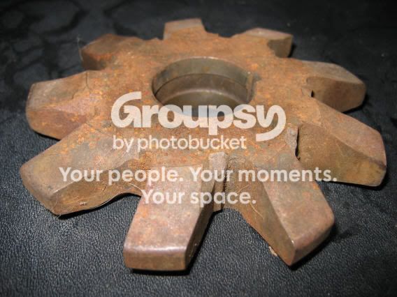

~~PHOSPHORIC ACID~~
Not my images but its done the exact same things to my metal parts. (my truck as well as motorcycle parts)
