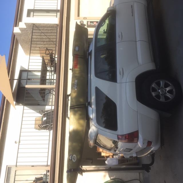

So background - skip if you don't care: Was laid off a few months ago and been trying to do a lifetime trip of 3 weeks fishing off my kayak throughout Baja before taking a new job. But have had a bad rattle somewhere in the undercarriage on driver's side. Tried the trip a month a ago and blew a tire and asked the shop to assess the rattle. Sent me somewhere else and screwed up sensors. Went to a 3rd and blew 2 days waiting for a support arm bushings and fixing sensors and ended up driving a day back home to reassess and get 2 new tires after also loosing a part of the kayak (6 days and $1.5k down the drain - to bad it wasn't pesos. Rattle is still there under certain road conditions and some other slight hesitation or oscillation (almost like a torque converter) under other conditions that I can't consistently repeat for mechanics. But noticed cupping on rear tires and a maybe a small old leak on the rear driver's shock. So they think it is the suspension. I now have a much heavier kayak with a support arm coming out of the rear hitch and load the vehicle up for my trips to Baja. Yet still drive dirt roads like it is empty because the 4runner drives smoother than going slower and I stay more alert - so I am sure the suspension has taken a beating - not to mention all of the stop and go traffic in LA. I don't think I need a lift - plenty of clearance and doesn't seem to sag in the back when loaded up. But want something that will take the abuse of both LA and Baja roads with the yak loaded - but hopefully not as rough on speed bumps, etc. I may have to change vehicles once I get established in a new job - so another reason I don't want to invest tons on a truck w/so many miles.
