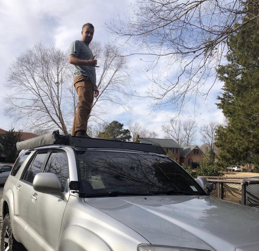

It takes my 175lbs just fine, even better if spread out over 2 bars

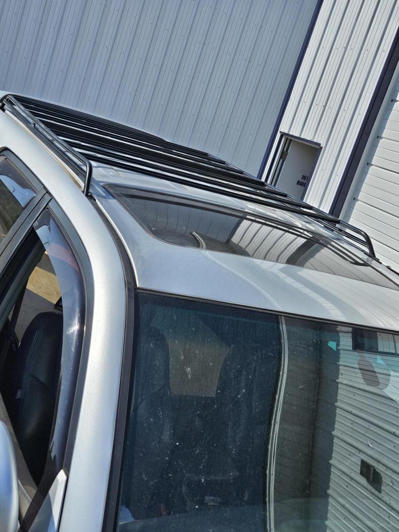

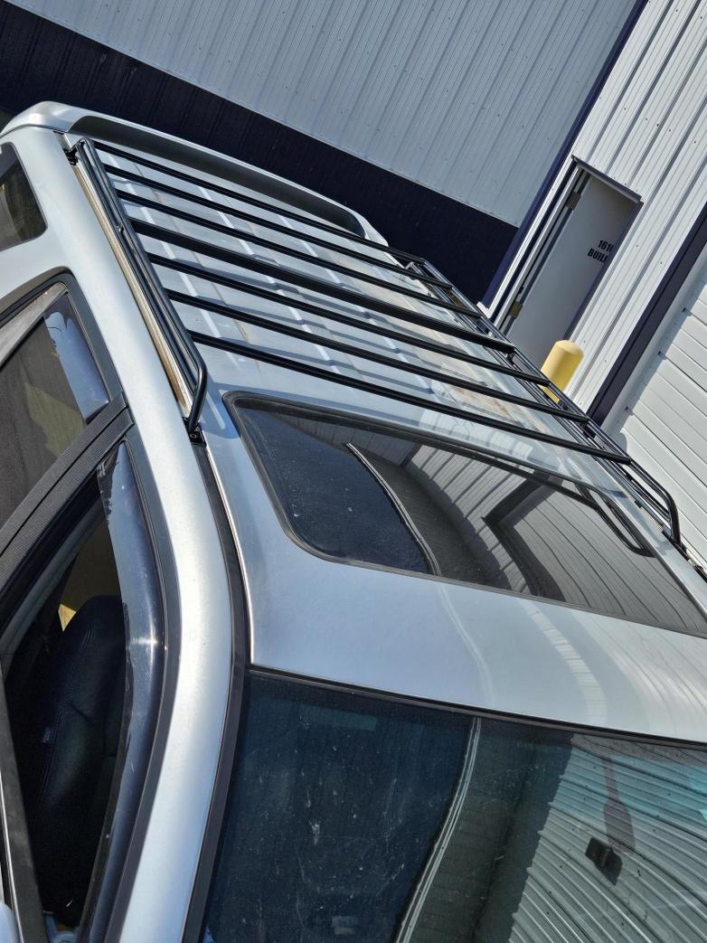

Can anyone help me figure out what kind of roof rack this is? I'm attaching 2 photos. I really like this guy's build, and I want to copy that roof rack. I currently have a full-length roof rack on my 4th gen, but I would like to switch to a half-length roof rack. And I just love the look of this one. But I can't figure out what kind it is. Also, it seems to be mounted on cross bars that are bolted on (i.e. not mounted on the factory rails)?
If anyone can help me figure out what kind of roof rack this is, I would really appreciate it!
