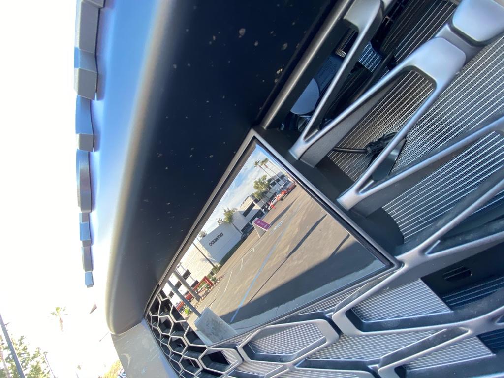

Stick with the OEM. They fit perfectly. You won’t have to dremel around the sensor like others have with the knock off garnish.

2019 grille fit fine on my 2020, I didn’t have to cut around the bottom pre collision sensor like other people did.

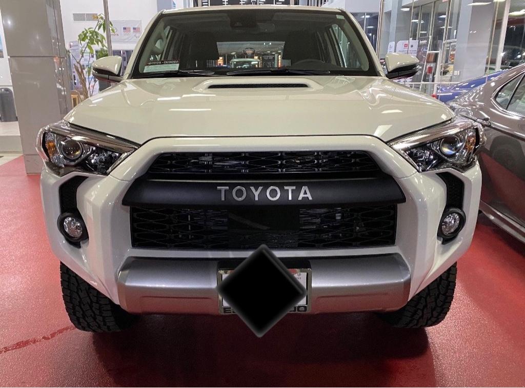

I did not modify the top bracket at all. It fit fine for my 4runner. A lot of people say they had to cut the bottom portion to allow the pre-collision sensor but I just fit mine in front and it was an exact fit. I used a 2019 OEM grille not a replica but it still saved me $200 vs. the 2020 grille

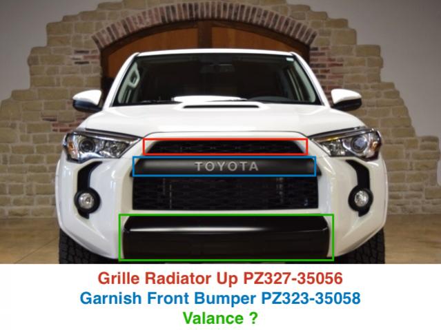

I am looking at changing the look of my 2020 TRD ORP by giving it the Pro look. Can you guys verify the two parts below and let me know what the part numbers are for the front and rear valances? Also, any recommended sites to purchase these at a decent price would be appreciated as well.
1. The Garnish Front Bumper PZ323-35058 is the actual TOYOTA bar? (see picture below)
2. The Grille Radiator Up PZ327-35056 is the replacement grill above the TOYOTA bar. (see picture below)
3. What is the part number for the front valence?
4. While I am at it :). What is the part number for the rear valence?

Colt,
Your current drawing is correct.
1. Garnish is the plastic overlay that has the word TOYOTA centered w/ raised plastic letters.
2. The TRD PRO Grille radiator upper piece replaces the current TRD ORL piece.
3. OEM Toyota Black TRD Valance Front: 53901-35250
4. OEM Toyota Black TRD Valance Rear: 52169-35120
