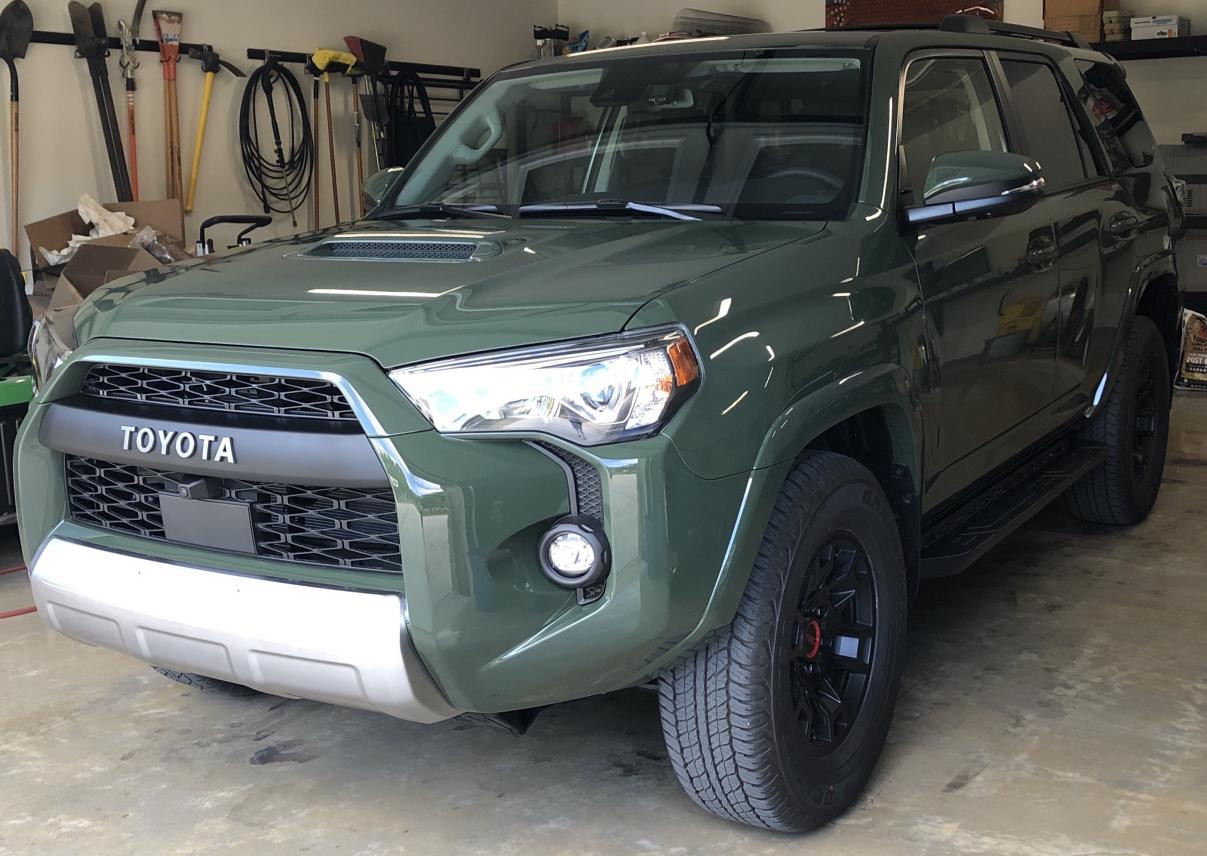

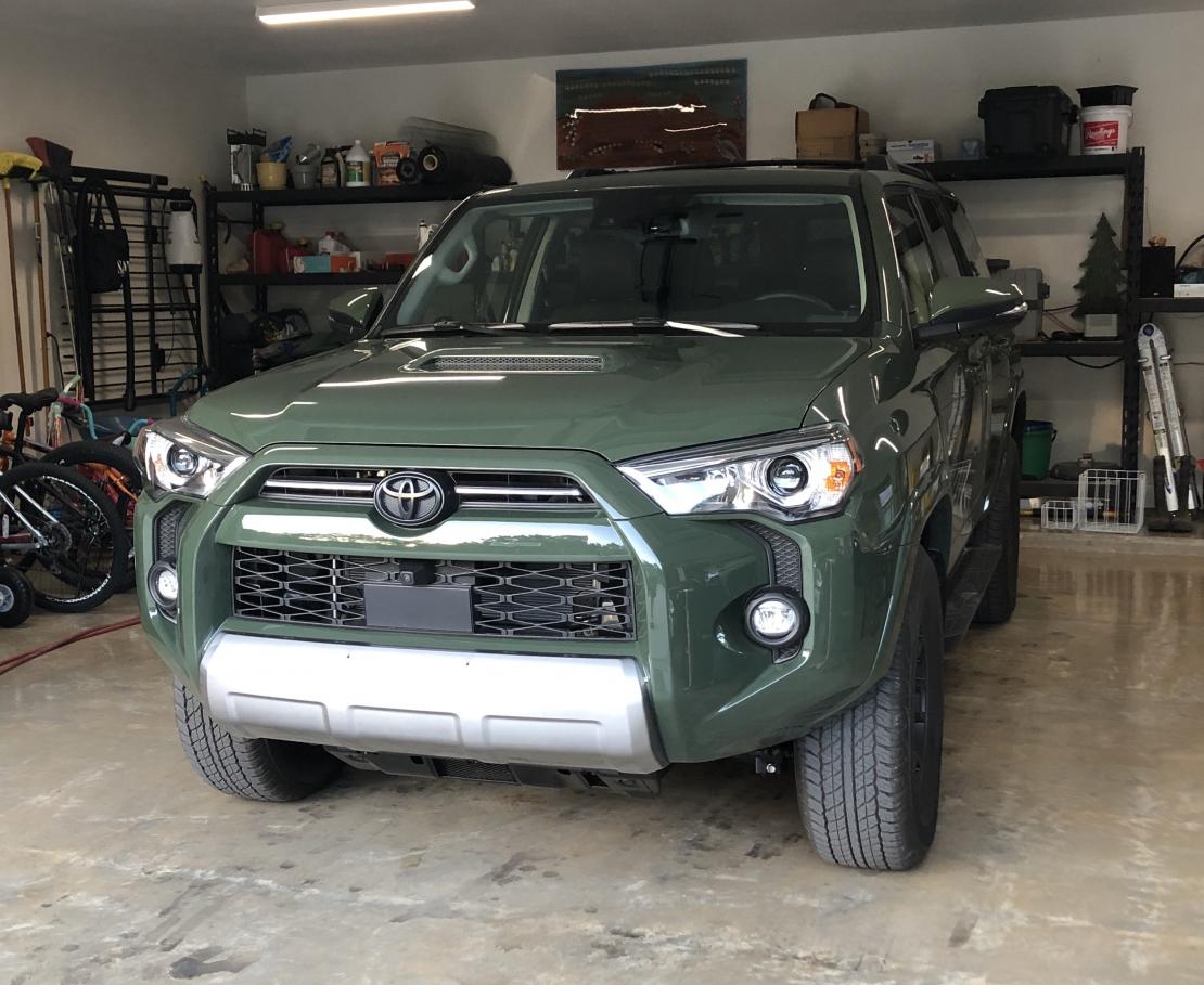

Finally getting around to posting my grille install from Mcgeorge Toyota. Highly recommend, as the quality and fit were OEM.
I bought mine from McGeorge Toyota online parts. Not sure what the current price is now but I believe it was 35% off list and I had the parts within a week.
Stick with the OEM. They fit perfectly. You won’t have to dremel around the sensor like others have with the knock off garnish.

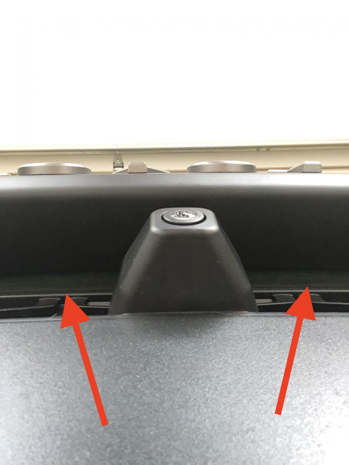

The upper grill is completely reconfigured. This applies to a 2018 Pro grille installed on a 2020 ORP. Only 4 of the 6 screws are in the same place, and the support bracket that ties back to the radiator support is entirely different. I have it installed, and it "works", but I also have the correct part on order so as to make it right. I'll take photos of the two when the correct part arrives and I swap it out.

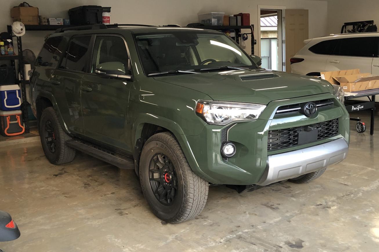

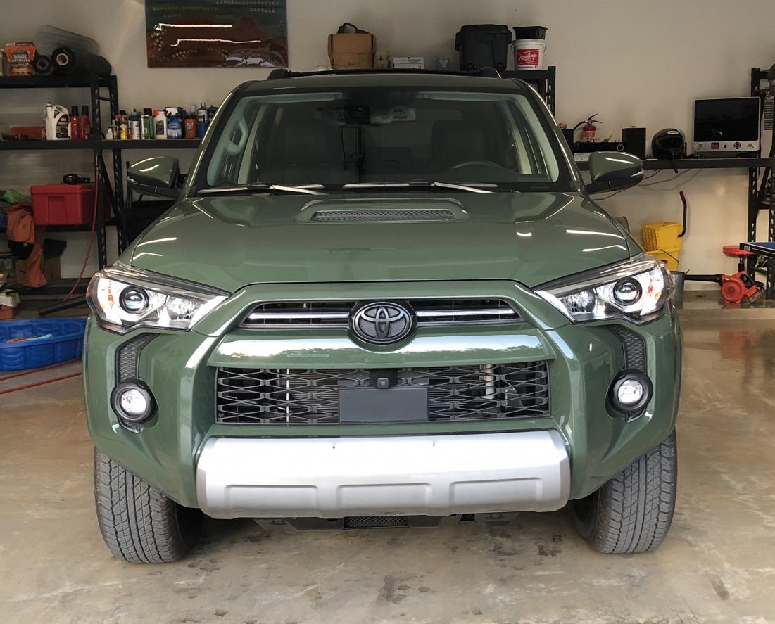

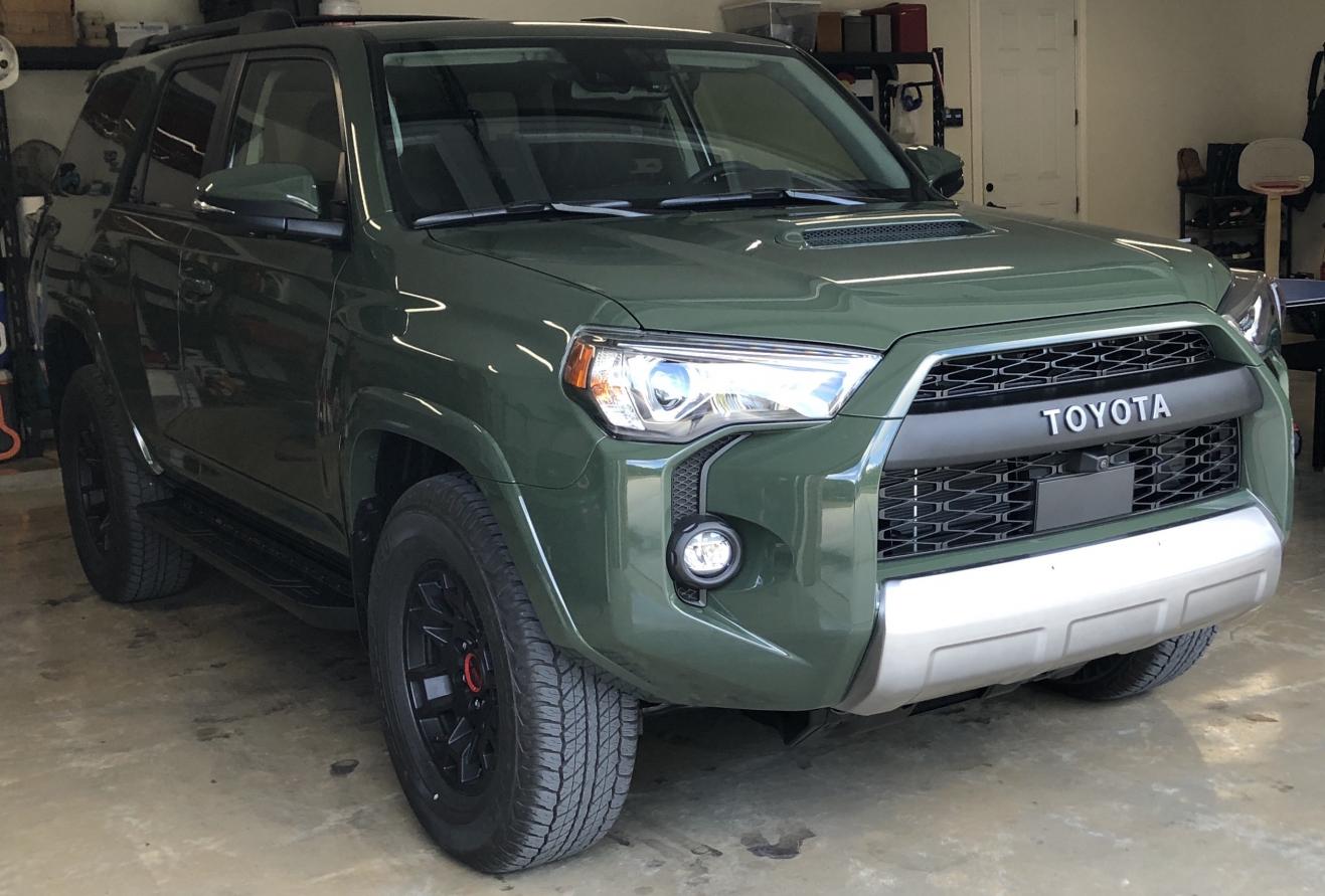

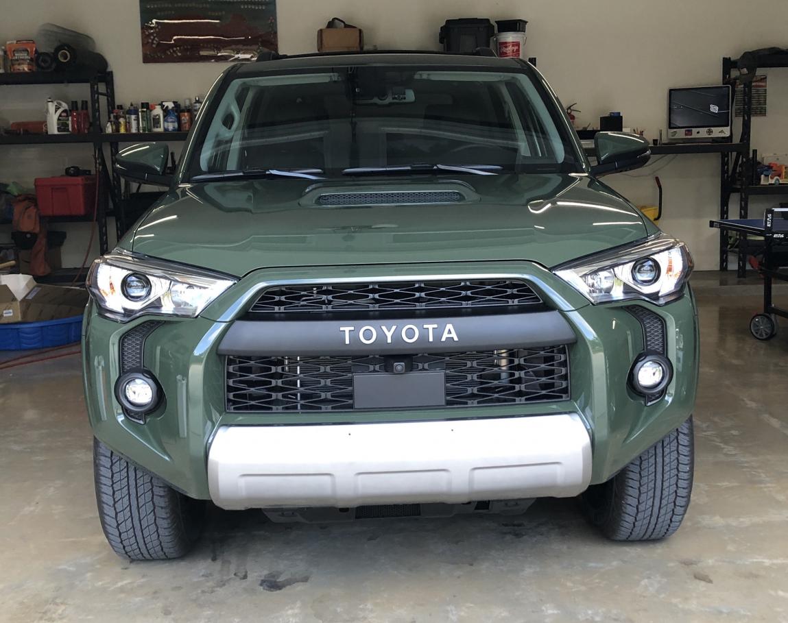

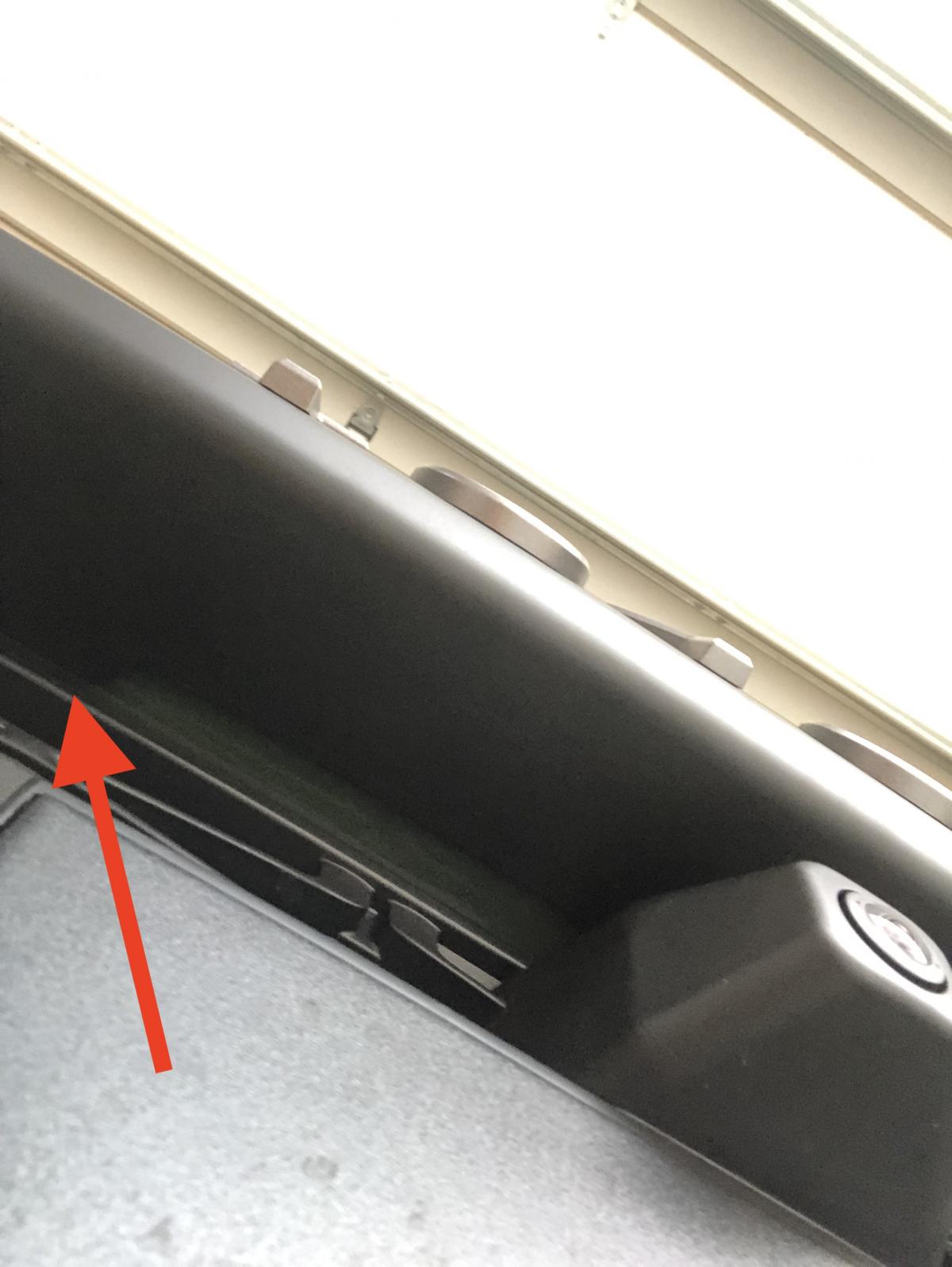

I used parts PZ323-35058 & PZ327-35056. The TSS notch is barely noticeable and not a concern at all (see pics).
Love the way it turned out!
