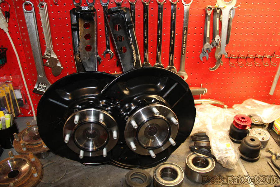

Alex, I have the details listed in my build here: Total Chaos Gussets
I picked mine up from Wheelers Offroad. Here ya go...Here's the link. Exact ones I have.
EDIT: So it looks like I picked mine up from TC not Wheelers. Anyway, at least Wheelers has them.

Yep and he says they are a superior design to TC's. I looked at the two side by side and the TC design only reinforces 2/3 of spindle top circle vs TS's fab. I don't know if they are in the store though and TC is much easier to order quick.
