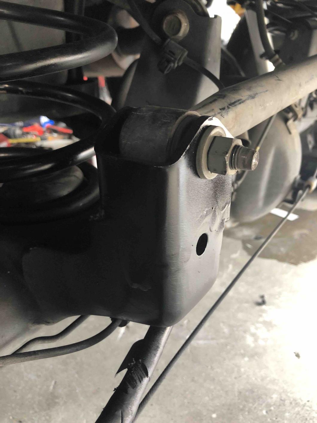

Figured I would share where im at so far. Got new UCA, 2.5 Icon extended travel coilovers, Icon 2.0 rear shocks, toytec superflex coils, and extended the panhard bar.
