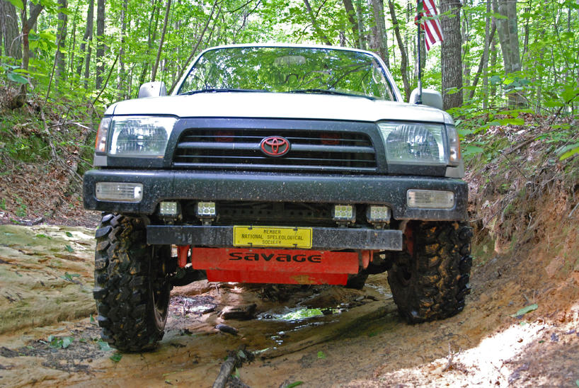

If you want tough sidewalls go with the TSL SX tires. I beat the snot out of mine when I had a 71 Blazer and never had an issue.
X2
I got well over 100 trail trips out of mine in the 6 years I had them. I NEVER worried about a puncture even down at 3-4psi.

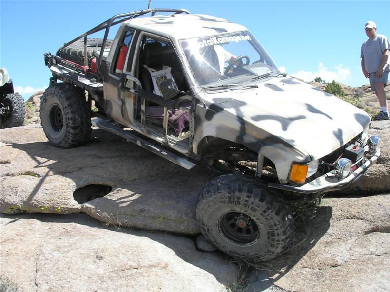

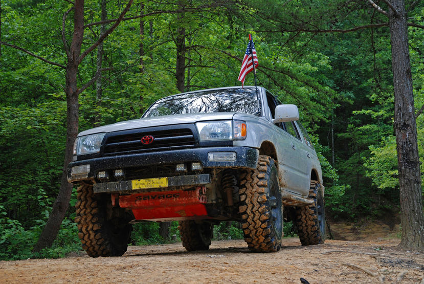

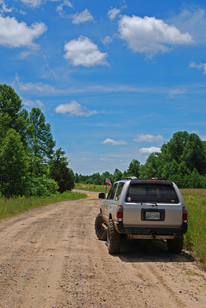

I got the 34x10.50-16 swampers in the end. I'm so glad I got the 10.50 wides instead of the 9's! I haven't been in the rocks with them, but I'm sure they will do great! I have just been on some dirt roads and shallow mud holes so far, and they did excellent! Hopefully, I'll be hitting some rocks next Monday...

Careful on the rocks. Tear them lugs right off.
