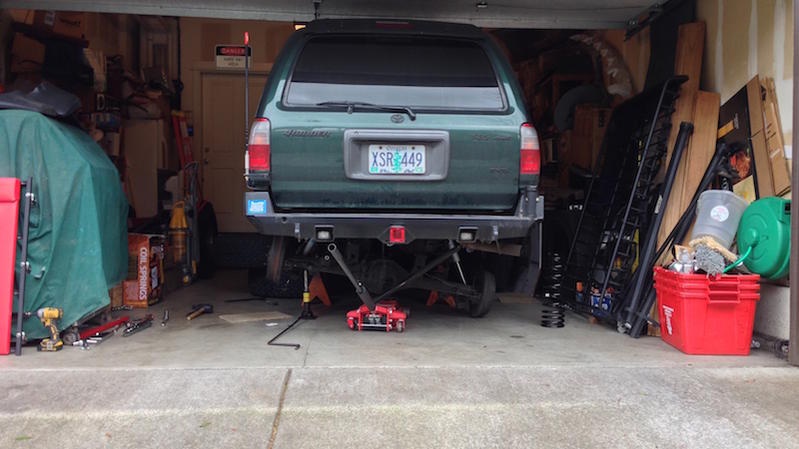

Loosen the control arm bolts! That axle will drop as soon as you do! You don't have to remove the control arm, just hit the bolts with an impact for a second each and it'll be way easy.
