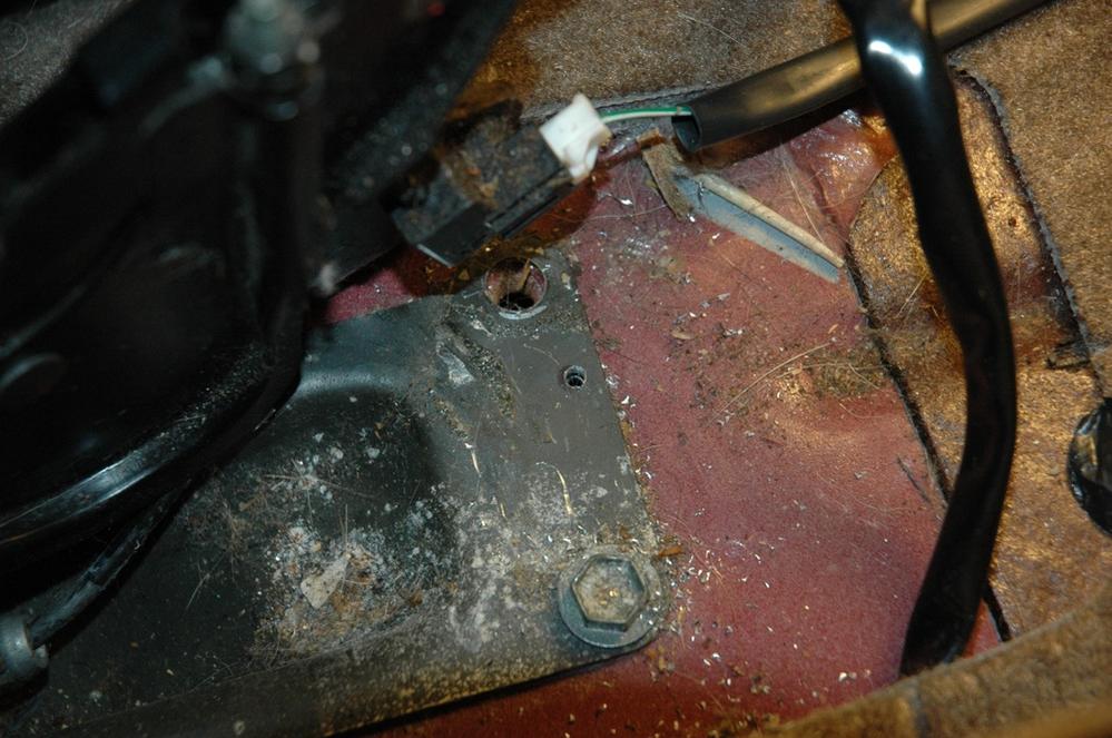

This is the image I found on Yotatech about "LCruner" replacing his top 2 switches, is this just the removal of the shifter surround? If anyone can chime in that would be great.
Drop the trans crossmember. That will allow a little more wiggle room for you to get in there.
If you go through the shifter, you need to take it ALL off from the inside if he truck. Out can't take that boot off without taking the entire shifter assembly thing off.
I can't quite tell from the picture, is that the shifter assembly he removed or is that under the cup holders / arm rest?
How much work is it to drop the trans crossmember and how much room do you think it would give me?
Thank you.
EDIT: This looks like it is under the armrest as a "Access panel", this picture was taken from the cup holder mod thread.
