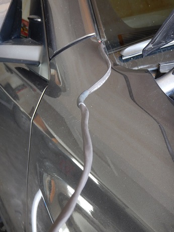

This is how I ran the wires for my GPS antenna on my 4th gen, right down the side of the windshield under the rubber trim, worked great
Run the wires along the weather channel next to the windshield, do some searching, a bunch of guys have done it that way!

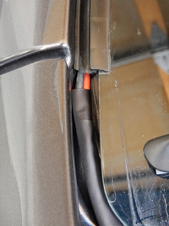

This worked for me. I had more space on the passenger side: was able to run both wires to the light bar this way.

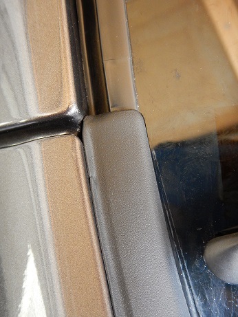

I have a Gobi and ran my front light bar up by the front windshield (positive u one side and negative on the other). My rear lights I ran through the back grommet. Works great and all hidden.
Is this on the roof or at the hood? Maybe a further out picture could help me figure out where this is.
Sorry for the late response. This is at the hood. Here's a shot from a little further back.
