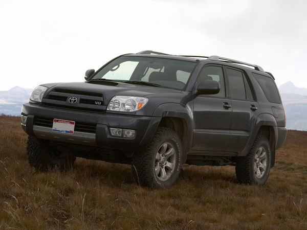

I have that setup: Daystar spacer lift and 265 70 17's. Might look a little smallish -- if I could easily do over I'd buy without XREAS and put a real lift and go up one size in tire -- ah, next time. P.S. I do get a bit of rubbing even with these at times.

Seals the deal
RapidRunner,
Thanks for the pic! That seals the deal for me.
Sure, bigger is usually better, but I think your rig looks sweet.
BTW, where did you get the Daystar lift? Do you remember the part number? And What did you pay?
