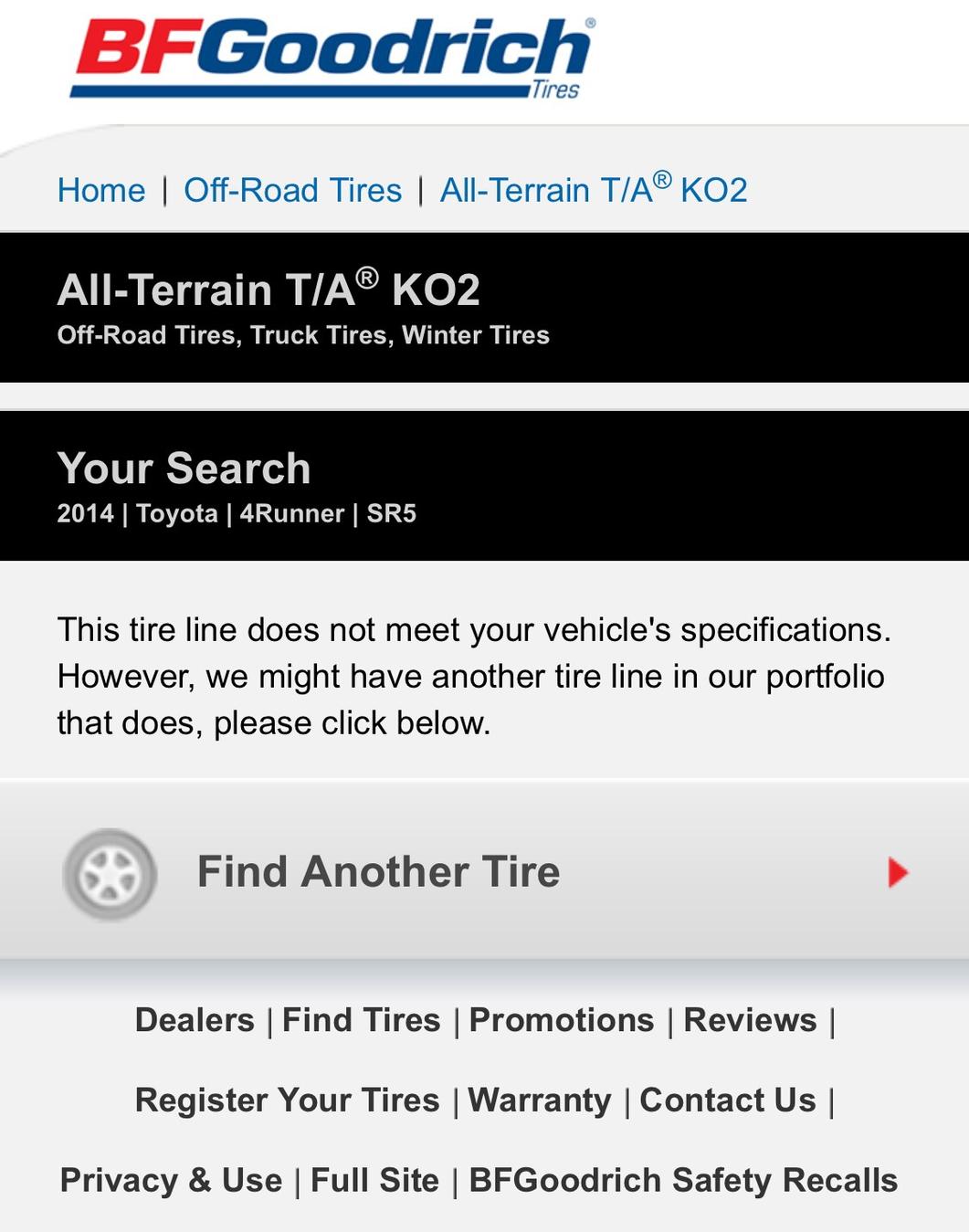

The tire in this thread doesn't seem to fit on your vehicle does it? I checked the 1st 20 posts or so and I don't see how this thread specifically was meant for an LT tire. My error if I am wrong, but I am not sure what your referring to sir.
Isn't this thread about "BFG All-Terrain T/A KO2", duh?
Why not? Many of us are using them. They fit perfectly, size and utility, both.
ALL of the KO2 tires are LT tires. That's why :)
Thank you bro, now I finally understand what fact he is missing!!!
