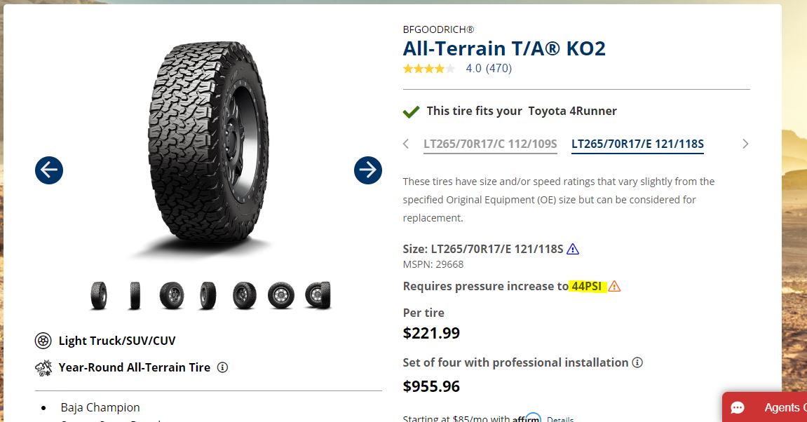

So when we picked up our 2019 ORP I was down at Discount tire 2 days later getting the Dunlop AT20's (IIRC) swapped out for a set of E rated KO2's, stock size 265/70R17.

BTW the BFG site shows to up pressure to 44 lbs for the KO2 in 265/70R17 on my 2019 ORP

This is correct. E-rated tires require higher pressure. Feel free to call Michelin/BF Goodrich to confirm this. Customer service will happily verify this for you.

Why would I call them to verify- it came from THEIR page on the BFG site.:rolleyes:

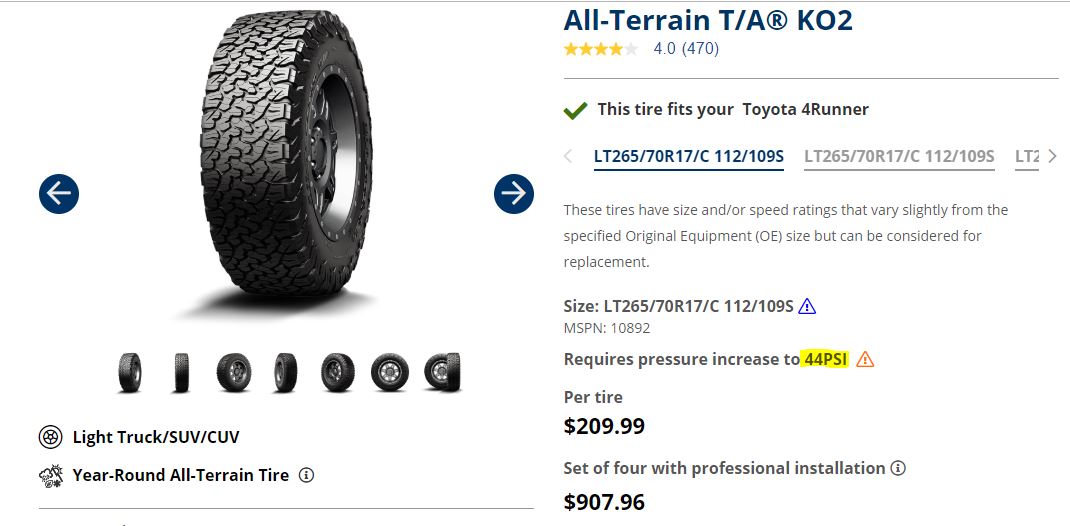

According to the BFG site the C rated KO2's in 265/70R17 require the exact same 44 PSI as the E range for the 4Runner
Time to add more pressure. I am currently running 40 front and 38 rear. I guess I should have done more research. Discount Tire installed them with 36.
no, being e rated doesn't mean it requires more air. this is a tiny SUV not a HD truck. Unless you wanna bounce your teeth outta your head than yea knock yourself out and max out those E rated tires. You air the tires up according to the max capacity of the vehicle. Heck even my f250 doesn't have the tires aired up beyond 50 until i tow.
our 4runner has e rated ko2's with 35 psi. they refuse to wear out. 25k miles and zero sign of wear.

no.
the PSI on your doors is for OEM or OEM equivalent tires, the OEM tire is a P tire
both C and E KO2s require higher PSI to match the original load rating
