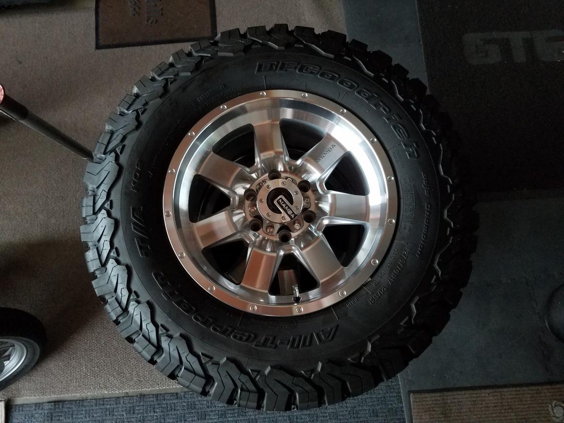

Got brand new KO2's installed on TRD pro rims today at America's Tire. Funny that one wheel has ~3oz, another has no weights, one has like 3/4oz and the other has ~2oz. Road great on the way home, hopefully it stays like that. I got a little worried seeing ~3oz on on wheel but from what I read online I think that's fairly normal.
