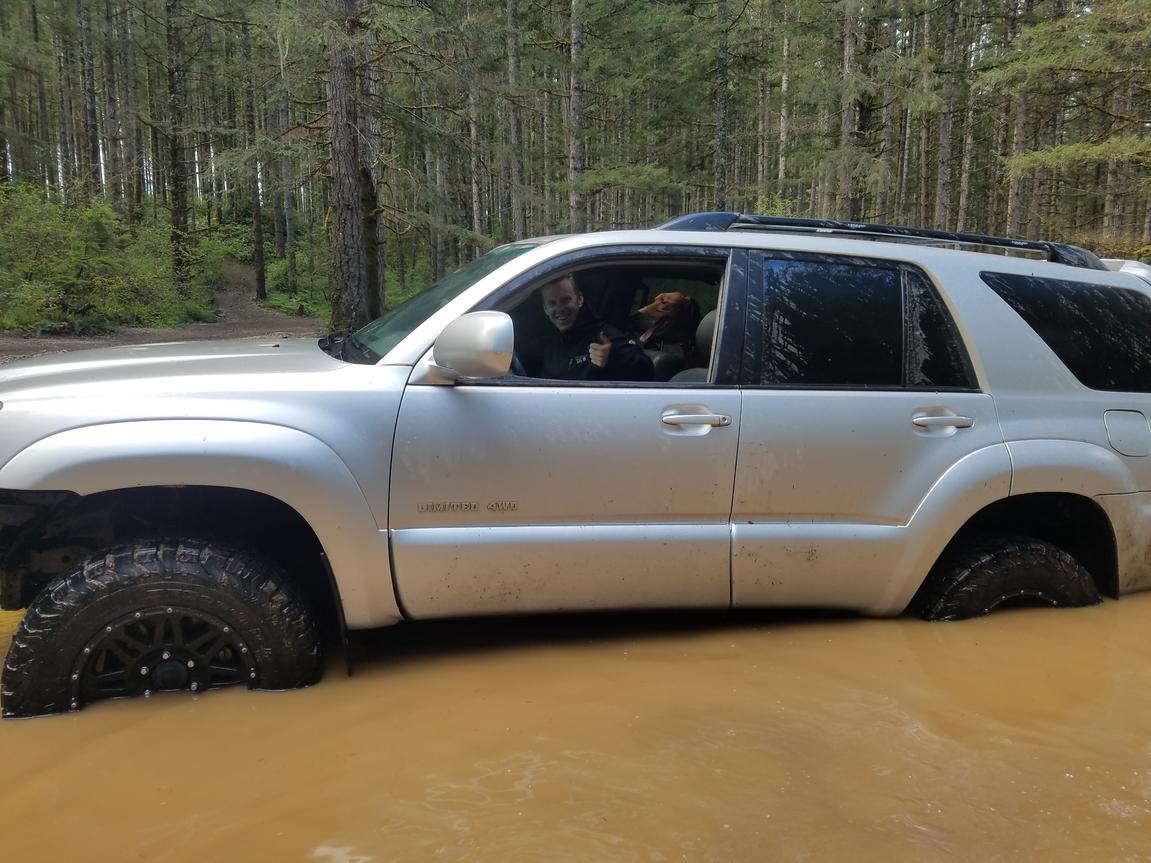

I've been now on here for a while but just did some work building a new metal bumper for my rig and took her out to an off-road area for a little fun. Hit a puddle too hard and hydrolocked my engine. Idiot city slicker problems trying things I shouldn't. Shop it's at says it's hydrolocked and has a bent rod or something so they suggest a replacement.
Currently finding out if my insurance will cover it.
Here's the dilemma I'm not going to want to hold on to the rig after the engine is replaced. I've just been getting tired of it and ready for something new.
So do I get engine swapped then sell it. Try to sell it to someone as is? Other ideas? Figure new engine will run me 4-6k and car is worth 12-16 with it in and only 5-7k with out?
So I'm hoping you guys can help with cheaper repair ideas, shop suggestions in Seattle for the work, ideas on what my rig is worth as is or repaired, other things my idiot butt should do.
Currently thinking of trying to get a 2 door imported g wagon with diesel or d90 after this is all said and done. Current rig is 2006 v6 limited 130k miles overland wharehoue lift. KO2s on it.
Thanks from an idiot!

damn! that sucks.
I think you will end up being upside down whether you fix it or not. it really depends on how much you still owe(if any). I really doubt anyone is going to pay $5k for it with a blown engine though.
if the insurance will cover it, it should be a total, if that is a true figure for getting the engine replaced. in which case, that is probably your best course of action.
edit: sorry, I meant to ask, is that an actual price quote you got? or just a guess on the replacement cost? seems high to me.
Ouch, that's a bummer. I'm not a big fan of shops but the price they quoted seems realistic. I'm assuming that's parts and labor. I'd always be skeptical of the diagnosis. Obviously we're not there when it happened, so it would help to answer some questions.
How would you recall the hydrolock? Was it a violent event or did the engine just sputter out?
Did the engine ever start back up after the incident?
Will it even turn over by hand?
How did the shop diagnose a bent rod? We can assume thats what happened but sometimes an engine can survive such an event and simply flame-out and not start again with wet plugs, sensors.
What exactly did the shop do before calling it bad?
