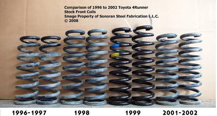

What is a stock set up? Different years came with different height springs.

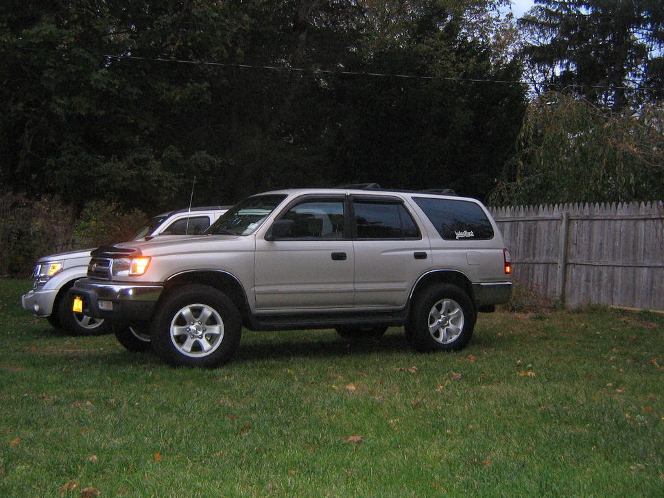

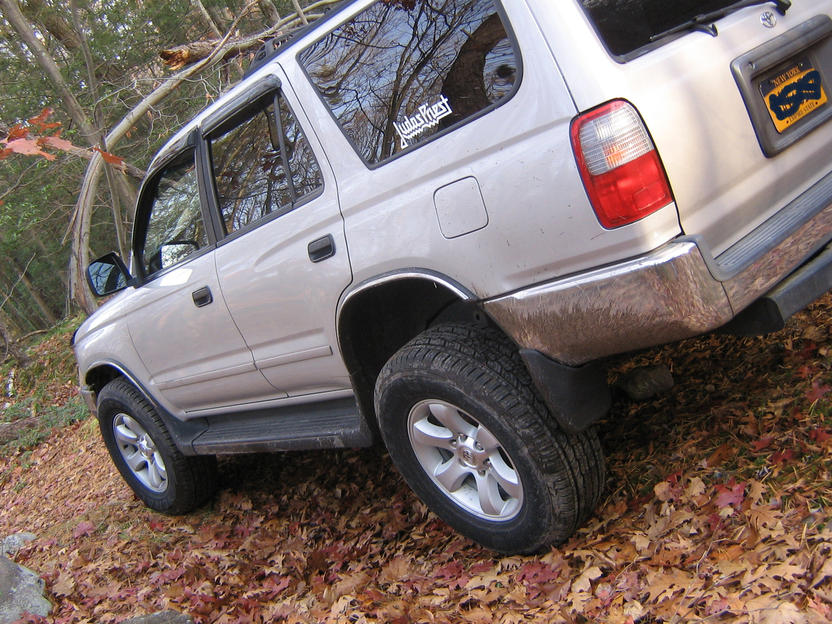

With my stock 99 springs I ran both 275/70/16 & 265/70/17. Both are around a 31.5" tire depending on brand & type of tire. HT, AT or MT.
33's will rub even with a 2.5" lift up front. That's why I installed a 1" body lift with 1.5" wheel spacers so I wouldn't have to do any trimming or hammering.
Of course wheel back spacing come's into play so YMMV!
I bought it with the 16" 5 spokes. The tires had decent tread and i think they were Michelin. 2nd or 3rd set maybe so not from the factory but definitely 265/70 16
That looks great! You also have a 2" lift where I'm totally stock.
