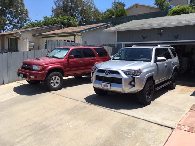

People say 32's and then mention 265/75-16 but isn't that is a 31.6" tire?

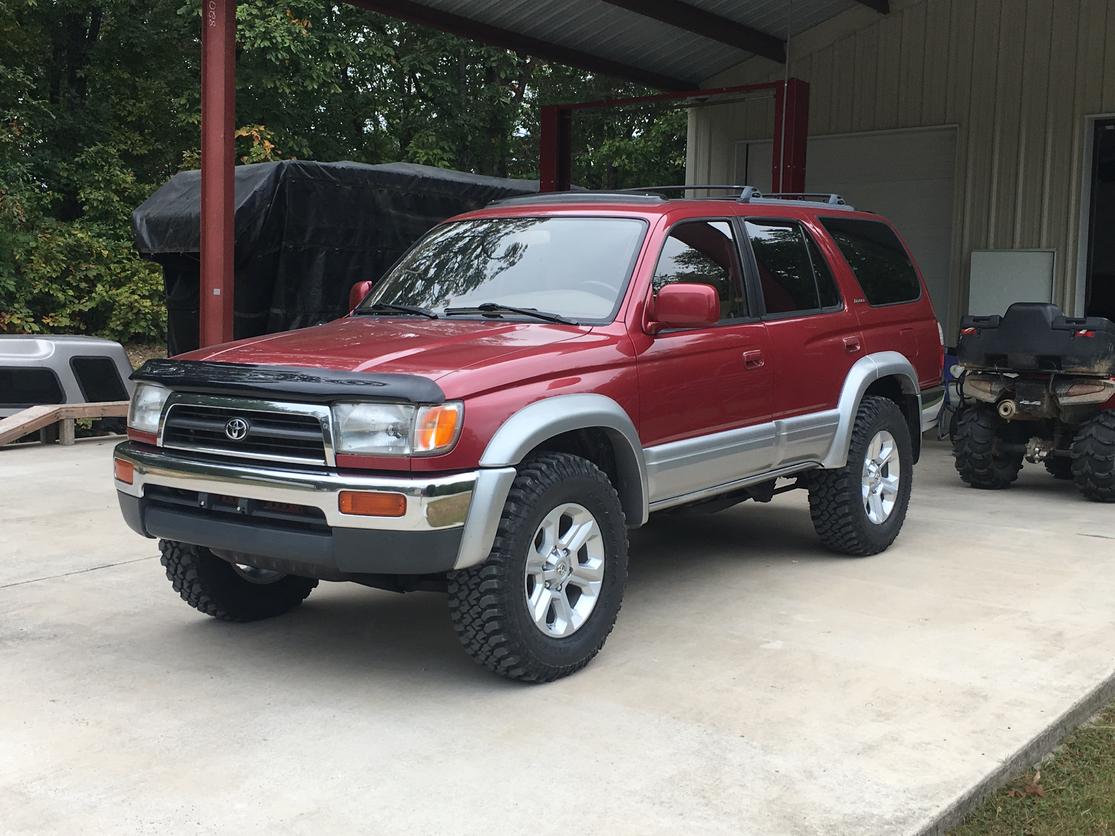

What about 285/75-16s - pinch weld mod or nah? :peace:
I'll put my quality engineer hat on for a minute and tell you that if the spec is 32, and I get 31.6... then it's in spec. If you wanted 32.0 you should have specified it as such!

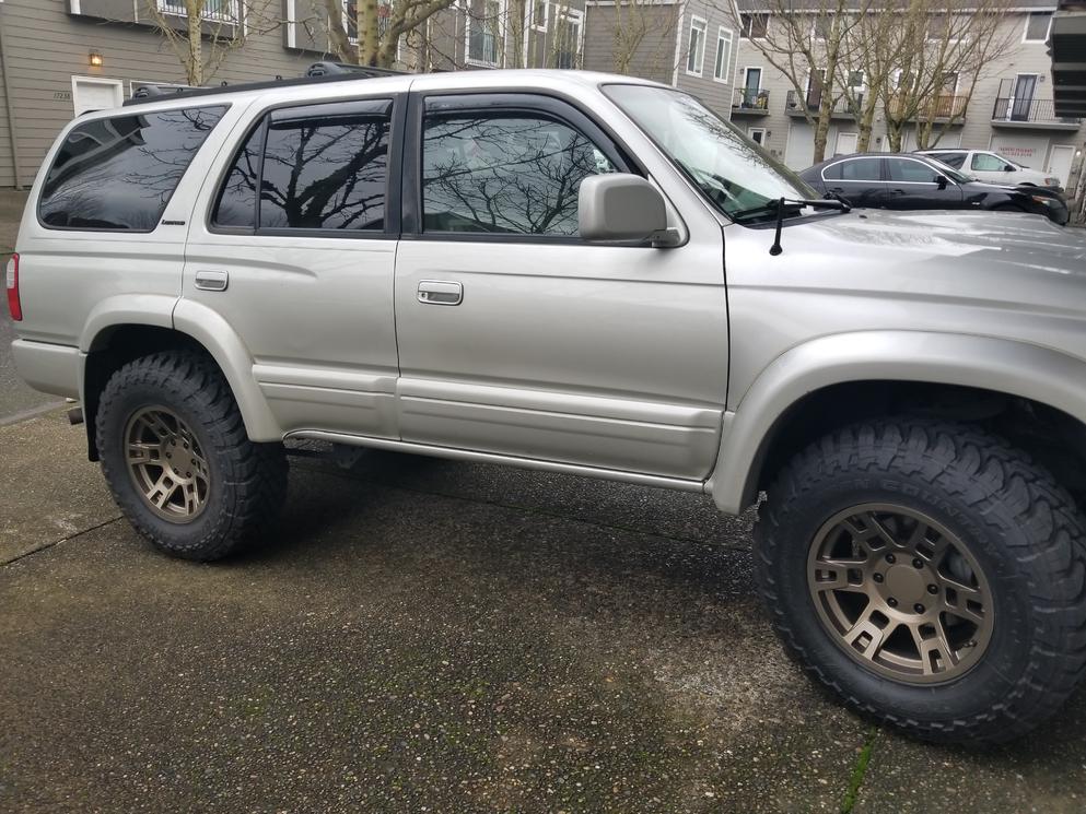

255/75R17 (32x10r17) they are c load range. I run 30psi.

I'm looking for a set of 17 Sequoia Rims, but if I decide against that I have been eyeing the Falken Wildpeak MT01 All Terrain Radial Tire in 265/75R16 with a 123Q rating
32" x 11" with a more aggressive tread for offroad use. 4 for about $720 free shipping and no tax
Anyone running these, how are their road manners, specifically highway?
I had them on my 02, they have very good road manners. Play with the psi for your liking, i ran 38 front 34 rear, great tire in my opinion.
I have 285's with relatively little invested to fit -
  • 1" BL (made myself, have machine shop in the garage)
  • $60 highlander springs
  • BFH to flatten the pinch weld
I have GY duratracs. The side lugs will rub the frame at full steering lock. The fronts will also rub off road at certain articualtion and steering angles. I've been driving the 4runner with the above setup for nearly 5 years now. If you know the shortcomings and don't intend to hardcore wheel it, it's fine.
$60 highlander springs :jaw: got link? :D
