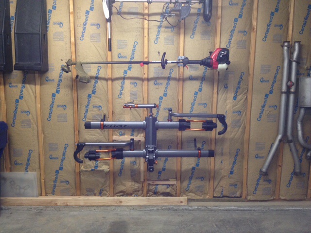

Cause I just did this...

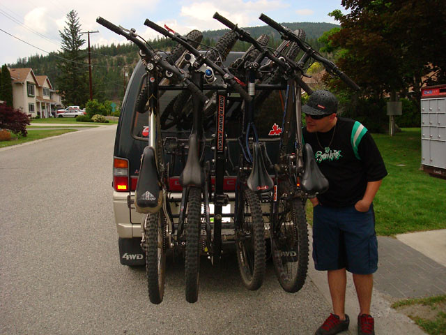

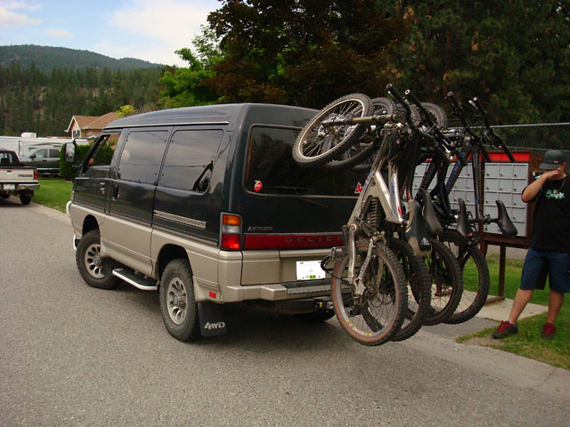

I am also running a North Shore Rack NSR 4-Bike rack for both our 4Runner and our Delica. Love this rack, including the fact that it can fold down with bikes attached. Easy and quick to load the bikes also. I highly recommend it!
I'll have to dig up some photos of it mounted on the 4Runner, but in the meantime, here are a few of it mounted to the Delica.
North Shore NSR 4-Bike rack webpage

Dug up some photos of the North Shore rack on the 4Runner...
One thing with this style of rack is that the bikes stick out the same amount, whether you have 1 bike on there or 4.
When folded up, it's tall enough that you can see the "uprights" out the back window, to judge how far away you are from things!
