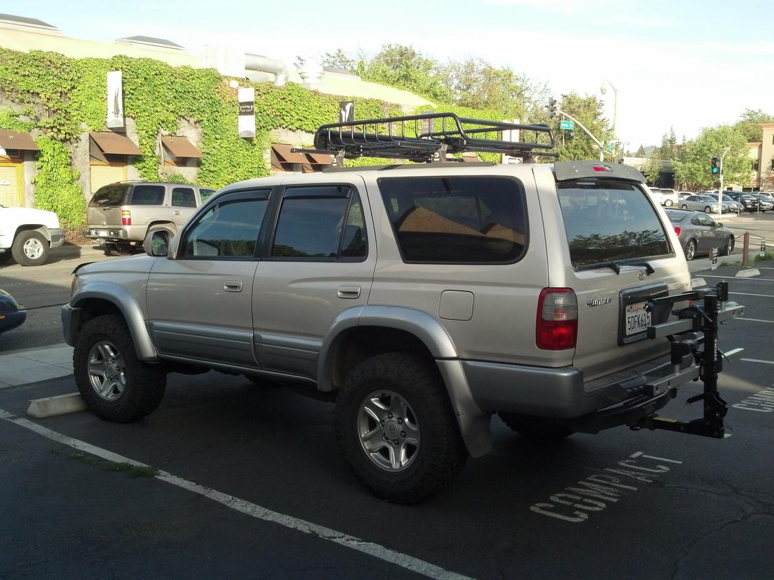

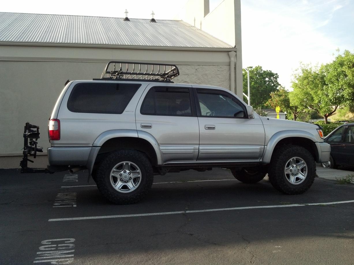

Finally a few pics
Hi Guys,
Thanks again for all the input. I'm up and on here because I couldn't sleep. So I will keep this one short. But I'm definitely looking into body mount bushings to perhaps calm down some of the noise and roughness in the ride--at the same time I am considering doing a 1" body lift. And since I believe I will have to dig into the steering assembly to install an extension there, I will also be looking into small parts for that area that will hopefully improve a very small knock I feel through the steering wheel when going into driveways, just to offer one example. So far the 880/906 combo with Bilstein 4600 shocks is doing just fine. As mentioned above, there is still an issue not related to suspension, in so far as I can tell, and I am still trying to chase it down. May still do sway bar bushing kit also at the same time.
Otherwise, brake work is needed now. It looks like anyone on here who has done the Tundra upgrade is 100% pleased with it. I've got a couple buddies who suggest doing drilled and slotted rotors, new pads, and a fresh bleed. And then I've seen others on here who've simply bled the system, replaced pads, and resurfaced rotors. Is there anyone who has experience with one or more of these that could offer their opinion?
Thanks again!!

Thanks a bunch for that. It's so cool to have people chime in, here and there, amidst the overabundance of information that is all already out there. Huge help.
I already decided on the 880/906 combo to run with my HD's. I've seen some people say that it is a rough ride, but we'll have to see about that. As many have read (or experienced, likely) it seems that roughness or lack thereof is just as subjective a ride characteristic as anything else out there.
In the end, I am just happy to know that this should be an amazing improvement over my dead stock springs, and that they will provide a very modest lift over stock (perhaps something like the '99 tall coils, but maybe a little more, and with greater weight bearing traits) without needing further mechanical adjustments to the truck (e.g., panhard bar, differential drop, brake hose extension), and without totally overextending the HD's.
Again, I took my 4runner to a recommended shop near me when I was having what I could only vaguely refer to at the time as, "suspension problems," and had a few bushings swapped out, along with the shocks. This was a fix I needed, but it was really only a small portion of the bigger picture, and had I been better educated at the time, I'd have done the shocks and springs and more lift and all the rest.
Thanks again to everyone who has posted or added something here!
