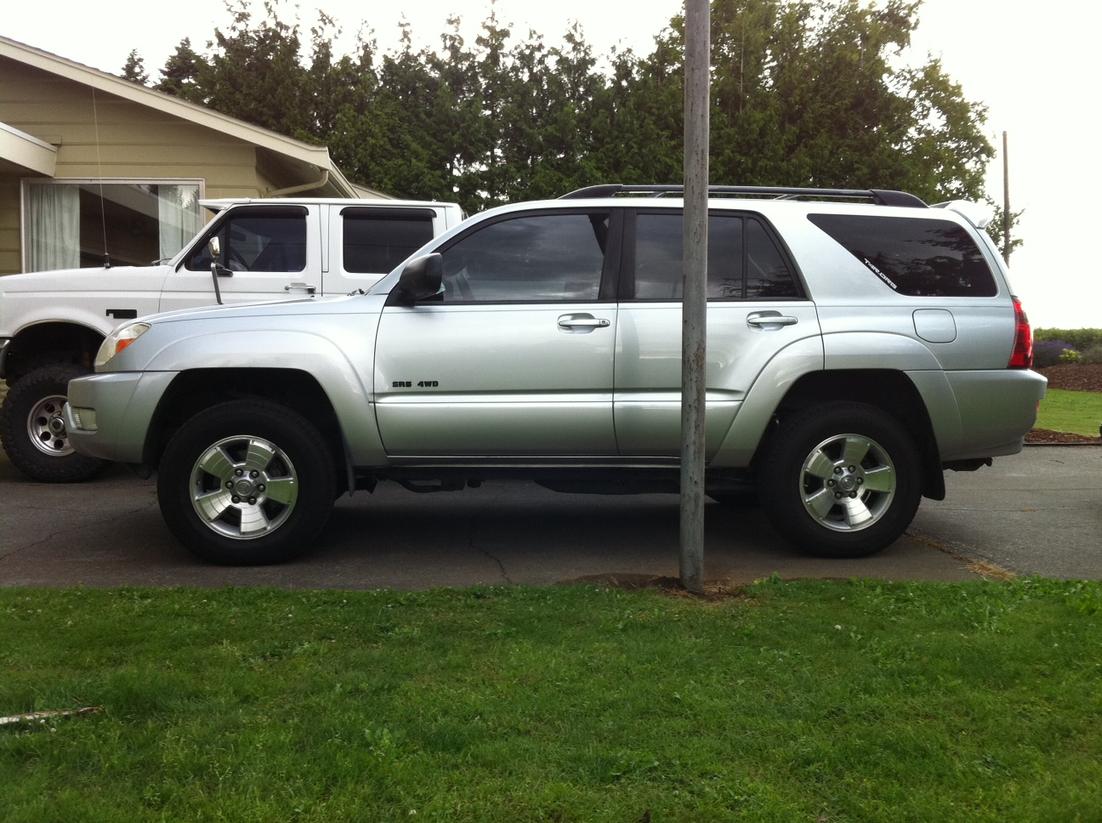

search back for my thread in the wheel and tire thread. I had pics of mine with just the stock springs set 1.75". I'd search for you, but even if I found the thread I cant see pics on my work PC

I thought it might have been a little nose high. I ended up adding a 1" rear spacer and its got a little too much rake. I personally think 1.75" upfront with 0.25"-0.5" would be just right. At this point im just too lazy to take the suspension apart again.

Here's a pic of mine at 1.75 setting. It's an '05 V8. I liked it at that setting, it was almost perfectly level but the lines on these runners make it look nose high. I think I had about .5" rake. I also had FJC coils on there. This pic was taken right after we did the install. I wanna say it settled a little but not much.
