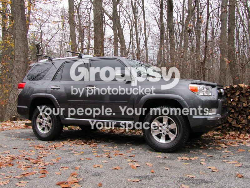

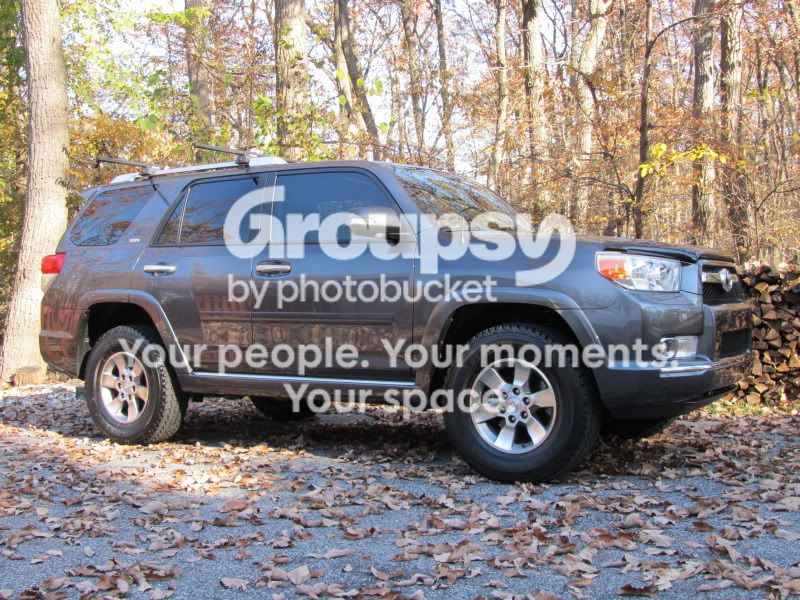

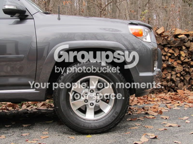

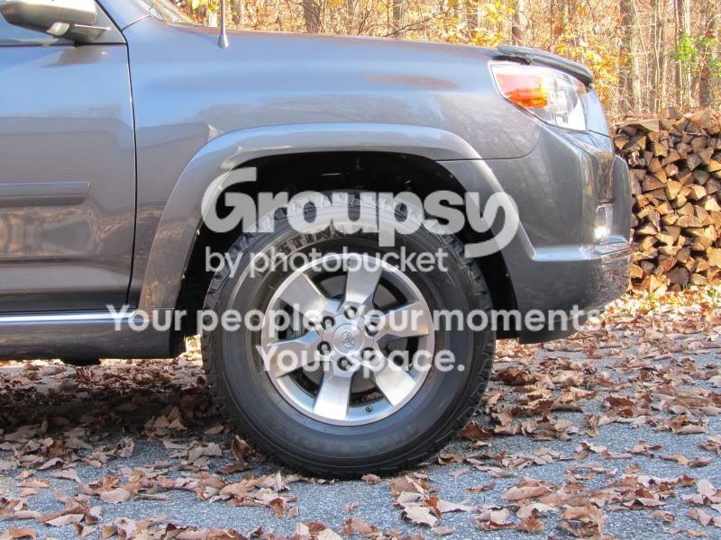

I did not want to hi-jack the other thread, so here are some pictures of what the .85 setting looks like with no lift in the rear, the tires are 275-70-17 Destination`s. I had a hard time finding some good comparison pic`s of before and after with this set up, so I figured this may help someone else down the road.
Before;

After;

Before;

After;

It`s not a huge difference, but it was exactly what I wanted, it still has some front rake to it, but it looks a lot better than stock. I do not think it`s going to be huge difference in handling either, but I have already noticed less nose dive during braking. I think the 1.75 setting may actually level the truck, but I was not looking to do that, due to towing a camper.

Thanks for posting these! I am on the fence with .85 or 1.75. These pics are helping make my choice.
@1.75in front.
In all fairness, you've got 895e rear springs as well. Along with 285s. These guys are comparing the front with no lift in the rear.
