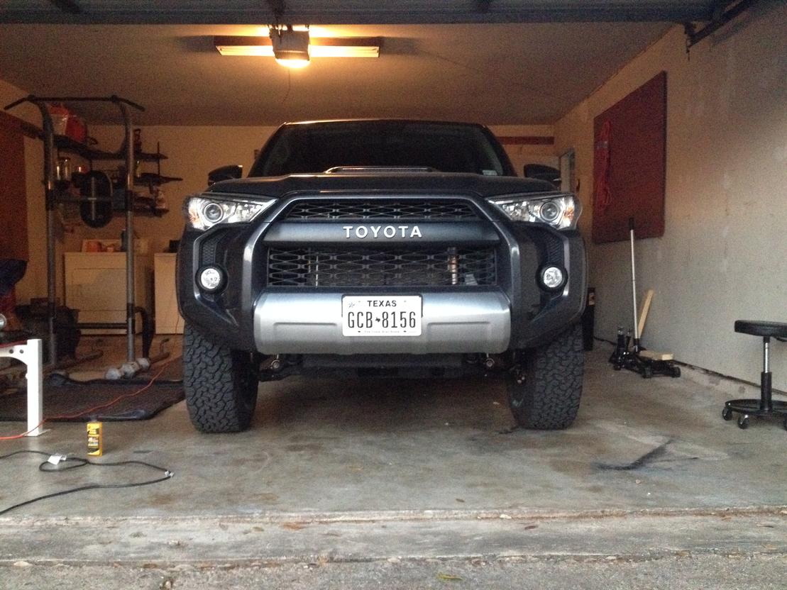

This is with 5100's front and back with stock springs. Front set at .85, did the swap in my garage without compressor's.

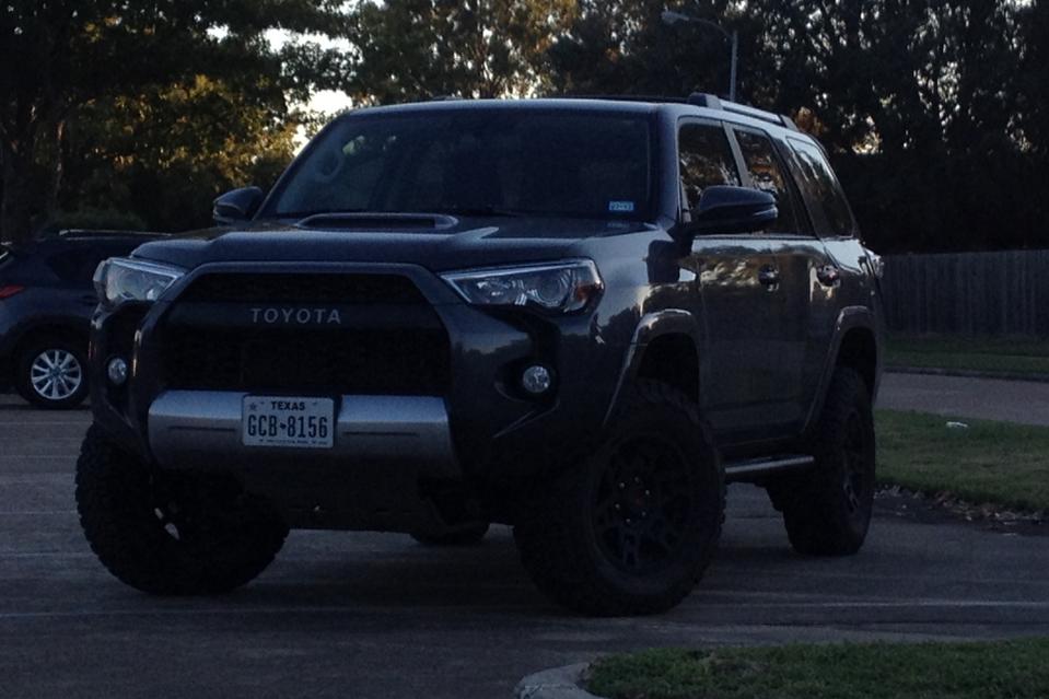

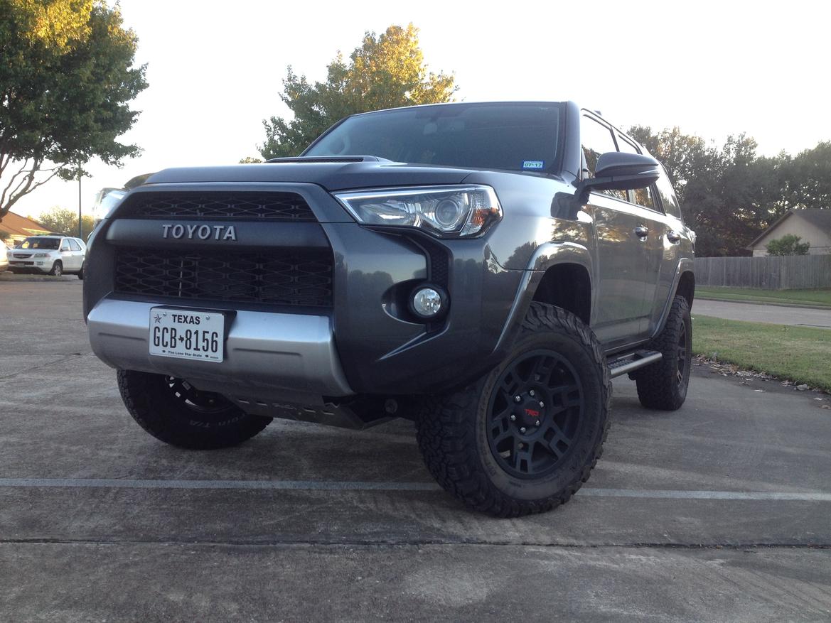

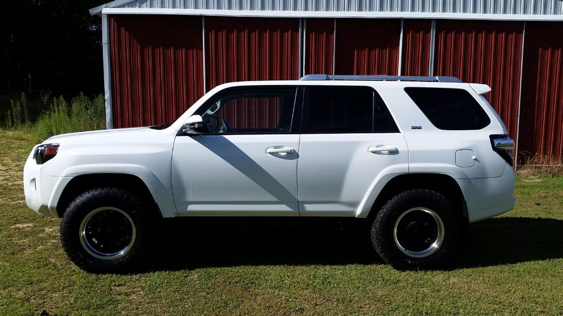

5100's installed .85 Front with stock springs.
I dig the look with just minimal rake. 265/70/17 Grabber AT2's installed. I'm selling my other car and turning in my work demo so this will default to DD duties. The elimination of nose dive while braking in addition to how much more composed the truck is than stock really transformed it.

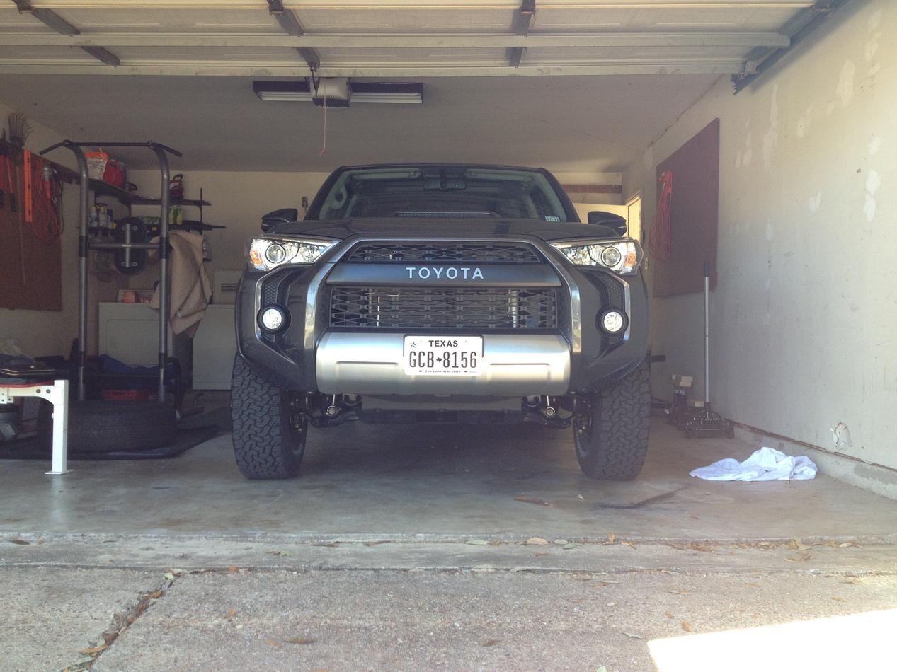

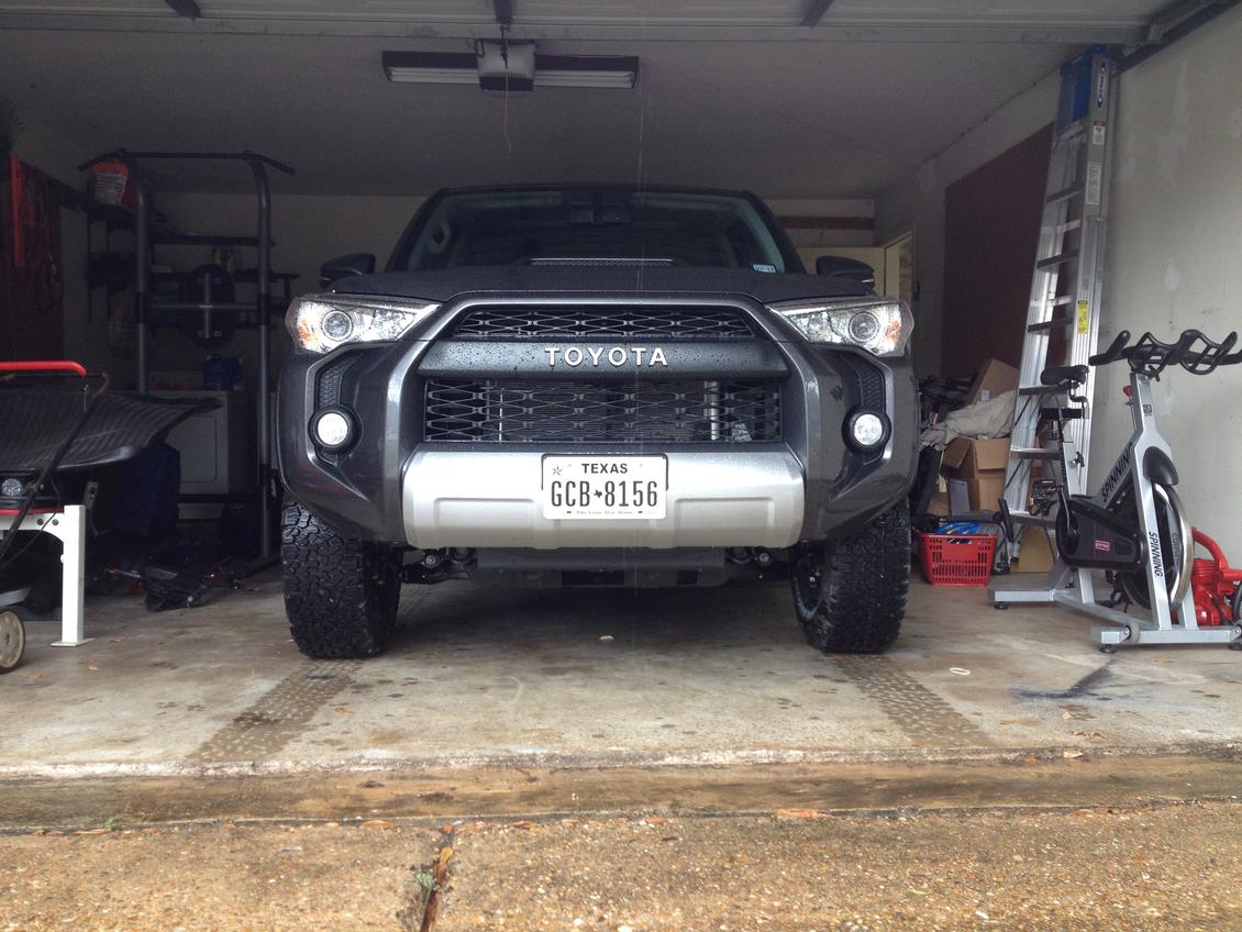

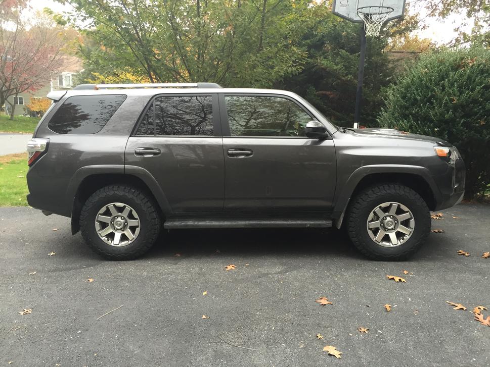

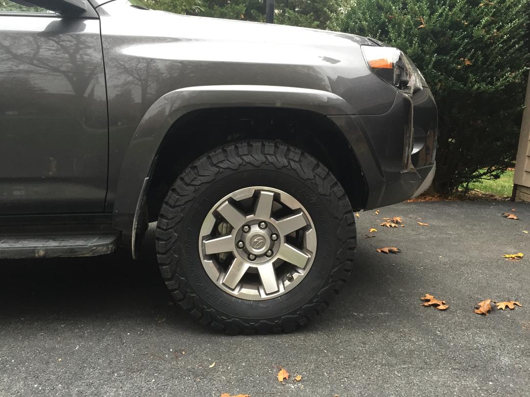

thanks! i do have the spidertrax spacers installed and 1" rear cornfed spacers.
for the spidertrax the front mudflaps had to come off and did the front fender mod. still a slight rub on the bumper cover piece that wraps under the front when full turn in reverse. soon i will muster the courage to hack that off....
couple comparison pics below:
A) stock suspension
B) 1.75" front
C) 1.75" front + 1.25" spidertrax
