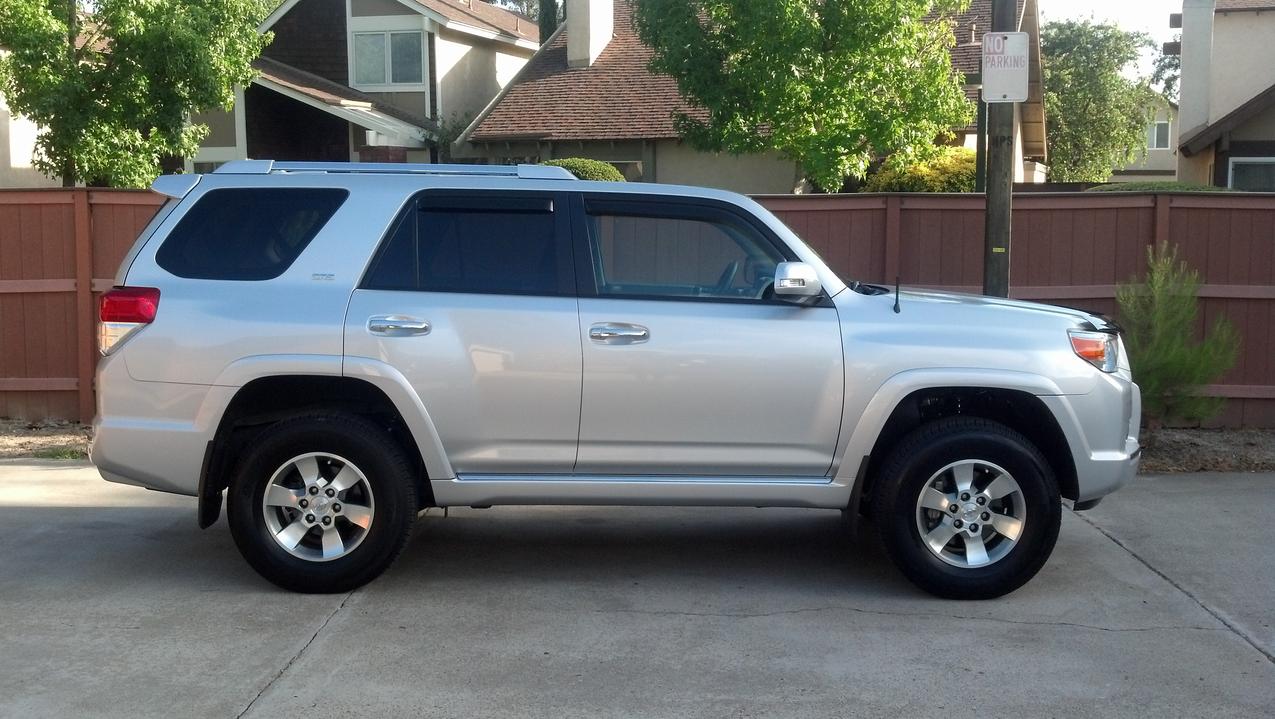

Mine actually has slightly MORE rake than stock (unless it settled down since the install), which is why Ducmonsta rightly chimed in. Turns out the 895Es lifted more than I expected. In the end, this turned out fine; I can load up my camping and photography gear and the extended family and the 4Runner still has a good ride stance.

Just had this done Tuesday...Bilstein's all around, front at 3rd notch (1.75) and 1" rear spacers. I am just about level measuring at the tops of the fenders.
However, with any load at all in the rear, it starts to have reverse rake. I have tried the airlift 1000, but they ruptured driving across country (would have been the perfect solution for me). So now I have ordered OME 895e from Wheeler's for the rear. I'm a little worried they will give me too much lift in the rear, but perhaps they'll settle with time and another trip with a full hitch basket load.
My tires are the stock Bridgestones....tires next!

Let me see if I can find the original measurements, immediate post measurements, and I'll get the current measurements to see how things have or haven't changed.
Do remember that on my 4Runner I did get a little more that 1.75in of lift.

Good question! Eric here at SoCal suspensions in San Diego took care of the order (I think he has a local manufacturer that he works with). I did not order online. I just measured for the heck of it: appx 36 1/2 front and 37 1/2 rear to top of fenders (on stock tires). I am sure the rear 1.5 inch spaces that you can find online would look good too...the real question is how these 895e's will turn out!
