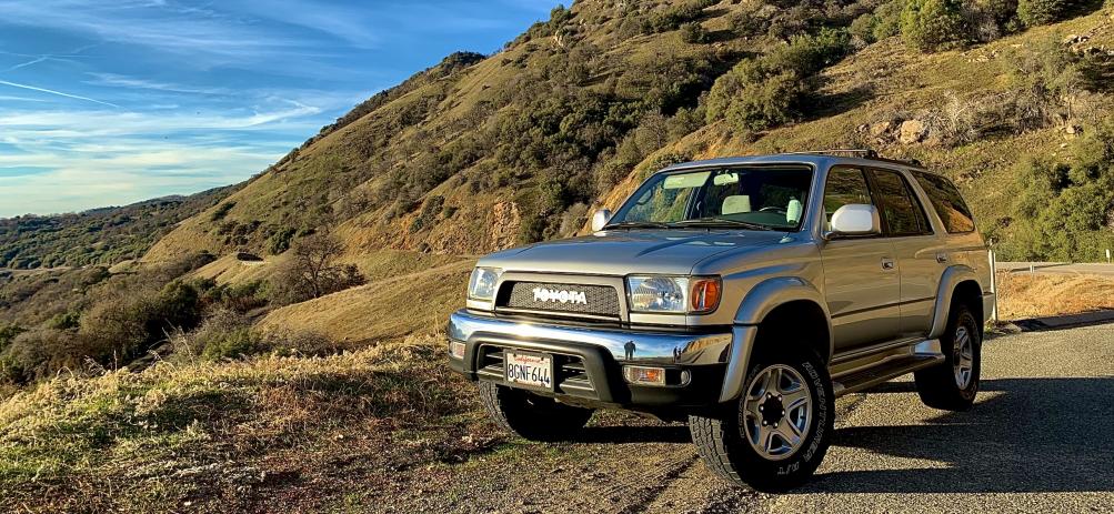

I just installed this exact setup on my ‘01, and I had the front set on the lowest perch. There’s a very slight rear rake after I finished the job, but it really isn’t bad at all. It will come in handy if you’re planning to carry some weight in the back. I carry two, sometimes three mountain bikes with gear and people, so the slight rake doesn’t bother me.

Do you have any pictures? Someone else posted on FB and it seemed like they only got about 1 inch and a lot of rake when on the lowest perch

Might have been me, but here’s a pic. I didn’t measure very closely, but there’s about 1.75” lift in the front, and about 2.2” (?) in the back.
