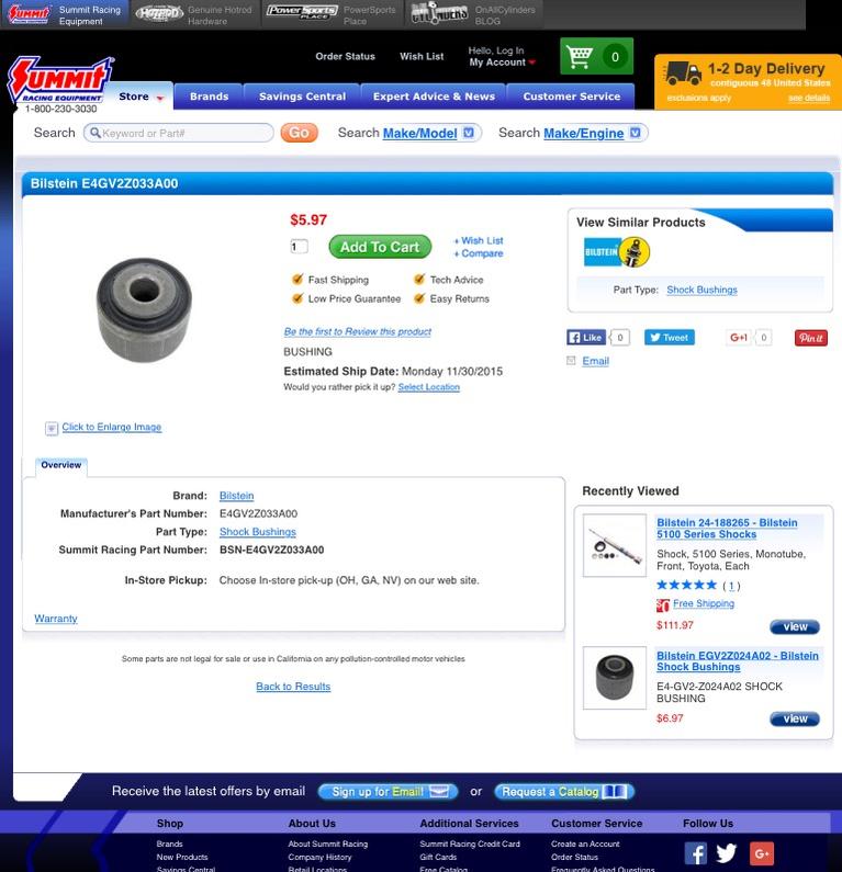

I've been looking for a replacement bushing for days. Every search I've done comes back related to the upper front bushings or rear lower bushings. Is there a replacement bushing for the Bilstein 5100 front adjustable shock? This is what I've found but haven't been able to confirm it will work.
Bilstein E4GV2Z033A00 - Free Shipping on Orders Over $99 at Summit Racing

Here's what I used to replace my 5100 upper and lower bushings with. I got 'em directly from Bilstein...
E4-GV2-Z024A02

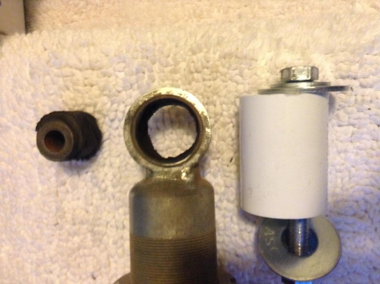

Great! I'll check it out. Second question. How did you push out the outer metal ring? I used the PVC setup with impact wrench to get most of the bushing out but the outer portion is still in there really good.
And your truck is bad ass. I've been following your build for awhile....nice.
Don't bother pushing the outer thin sleeve out, you have to cut it with a reciprocating saw since you won't be needing it anymore. The new bushings will come with them.

Thanks for the part number. The one in my original post was too big. I was able to get my hands on my mechanics press and used a socket to push out the ring finally. I'm sure cutting it would've worked too.

I believe the part in the first photo is the correct one for the tundra 5100 adjustable. I called bilstein and he gave me the same part number but he mumbled the last number so i thought it was a 2 but it must have been a 0. anyways ill order some up, ive got a massive drivers side lean, and im running the drivers side on the 5th perch and the passenger side on the 4th to compensate right now.
