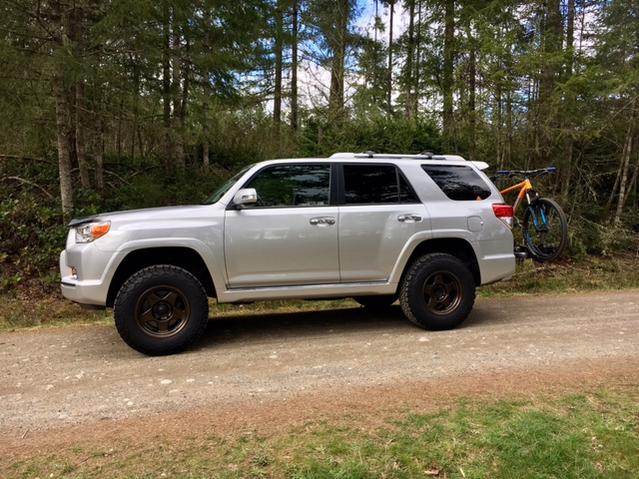

I am currently running the setup on some SCS F5s with BFG A/T KO2 275-70-17. Ran with stock UCAs for about 8 months no issues, but the ride felt dodgy and I was constantly playing with the steering wheel.
I added a set of JBA UCAs 3 months ago and the drive is much smoother with the added caster.

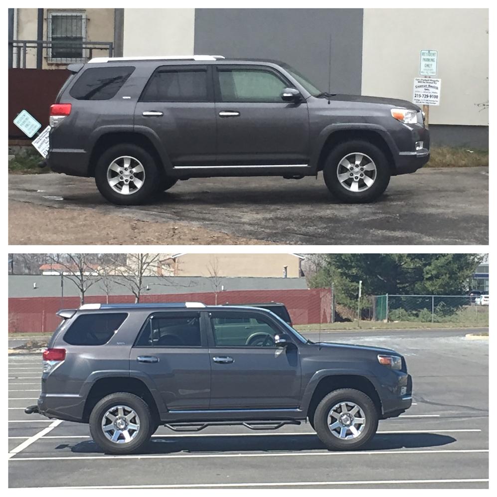

Lifted with Bilsetin's 5100
