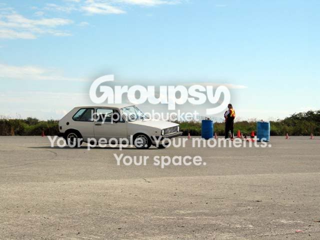

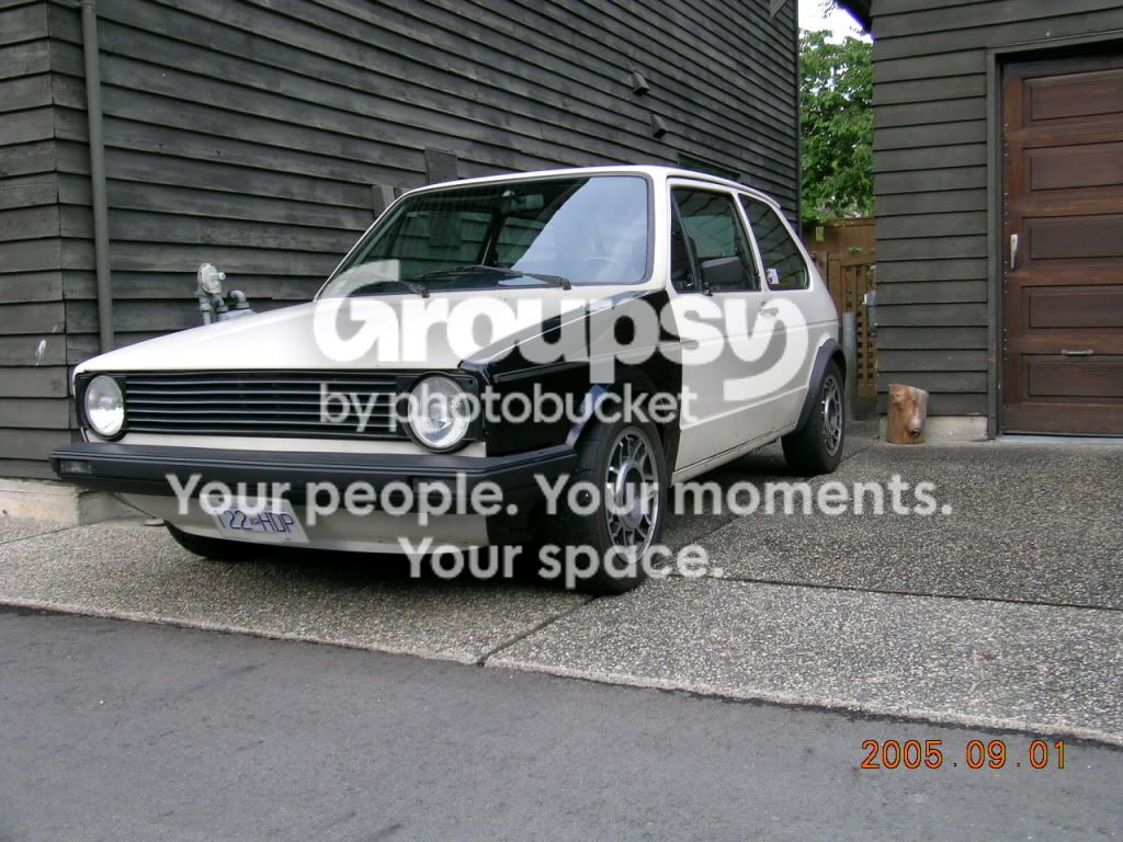

I'm about 90% sure about using the Tundra set up w/LC coils(given to me by a buddy). I had a Rabbit and an AE86 both modded a lot. Tried to use "factory" parts from other vehicles whenever possible. Overall seams to be the best combo for good/really good performance with lowish cost. Not mention less surprises too.
The Hell Rabbit
3wheelbunny_pic1.jpg~original

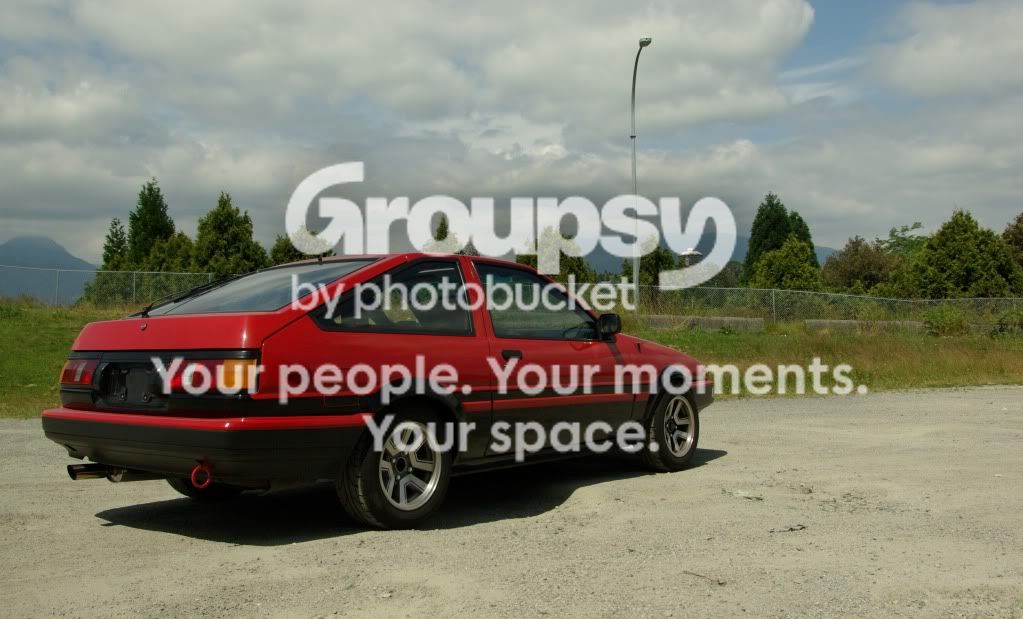

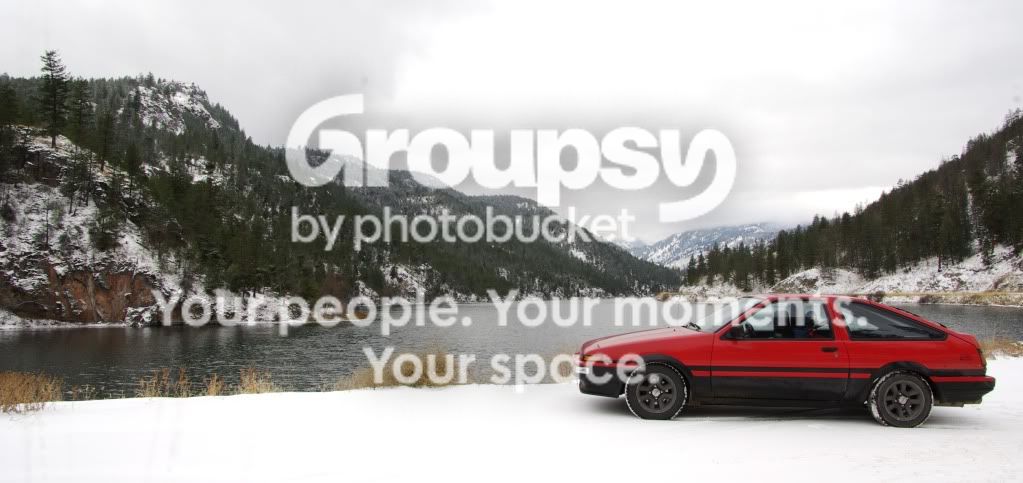

My AE86
IMGP7878-editedcopy.jpg~original
