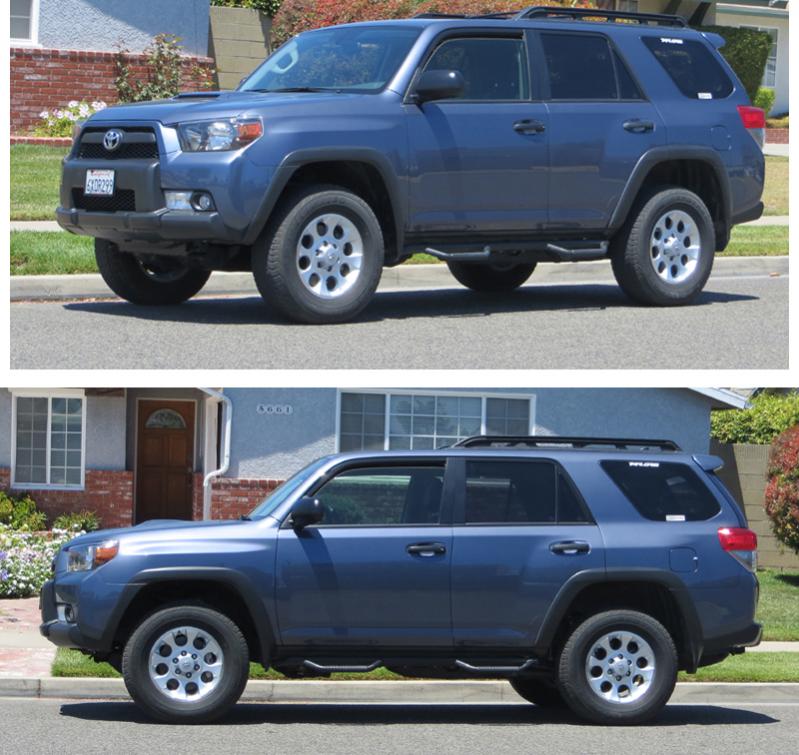

Bobstrail - Do you have a photo of your 4Runner with your setup?
Bilsteins at 0.85, no spacer in the rear. I do have airbags but they were at 5 psi.
