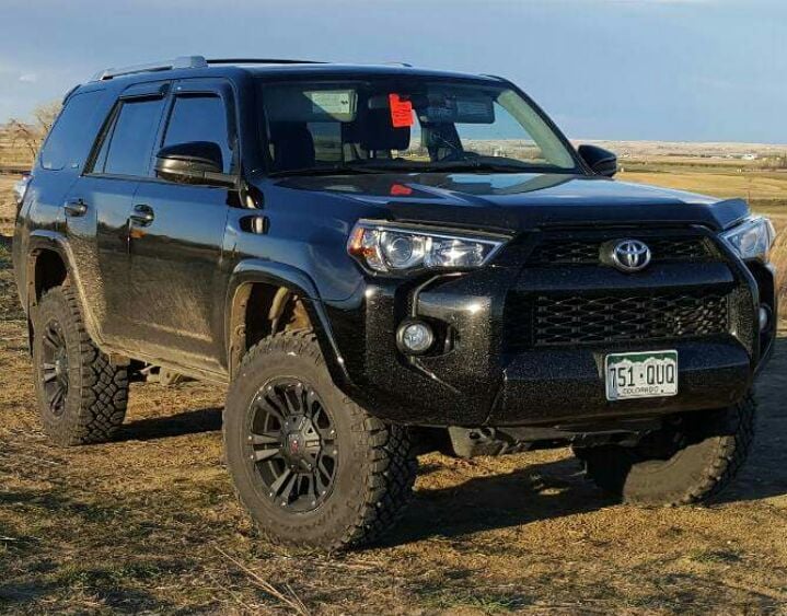

Bilstein 5100 all the way around. Front set on highest and 1" spacers I'm rear. I really like the stance I got with that setup. 275/70 17 duratracs

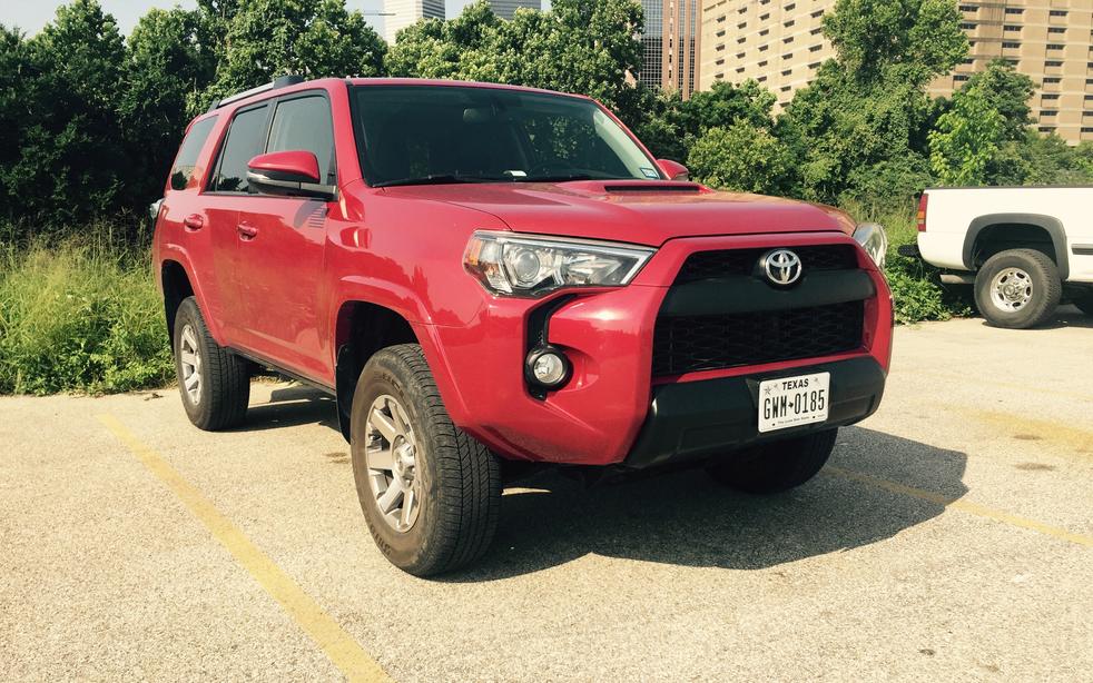

You be the judge. Mine are factory Bridgestones for now. I am looking to upsize when these wear down a little more, but for the moment, I don't think it looks too bad.
