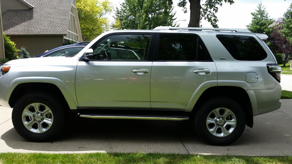

Here is my old Limited with 5100's all around and a rear spacer. Front was cranked up to 2.5" and rear spacer was the daystar 1".

1.75 and 1" spacers gives a nice, but not huge lift. You still have close to stock rake. The stock UCAs will most likely be adjustable for proper alignment. I just did this lift and added the 275/70 BFG KO2's and am really happy with the result.
Here is .85 on stock coils and no rear spacer.

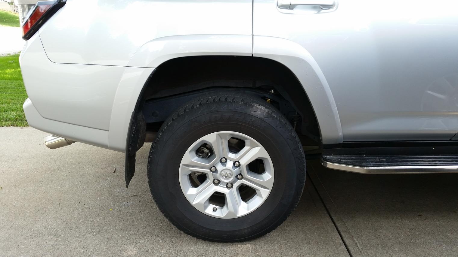

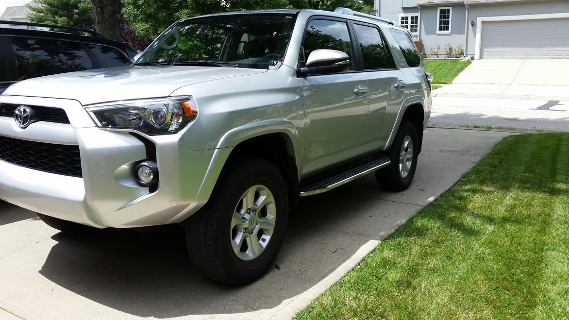

I went with 5100's set at 1.75 and added OME 895e springs in the rear with OME 60080 shocks. Looks great, rides great. Leveled it out a bit but maintained some rake. No complaints after alignment.
Driveway is on a slope making it look like it has some reverse rake, but it doesn't, I'll try and take a picture in the garage later
