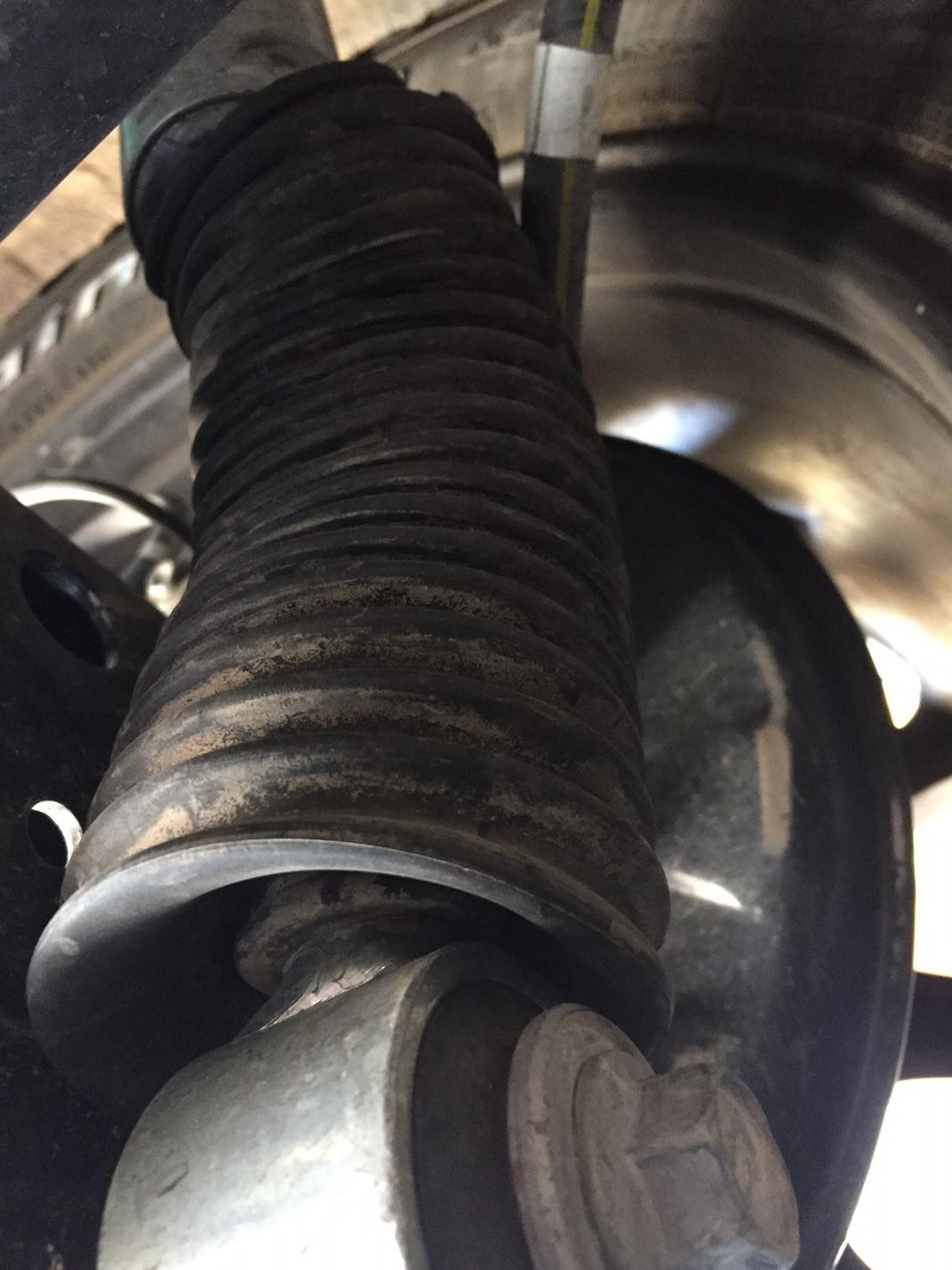

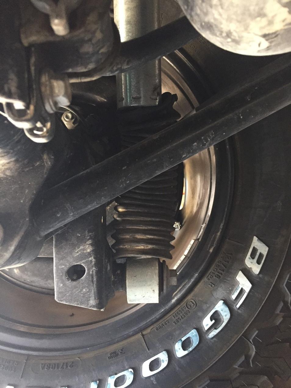

Has anyone had issues with the dust boot on the rears coming off like shown below?? I cannot get the boot to stay on the body of the shock no matter how well I zip tie it. Only one has the issue, the other side is fine.
Mine kept slipping off also. New zip tie did not help. When the boots slipped, the cone/bottom end inverted and reverted with the movement of the wheel, and maybe even jammed up against the shock body sometimes, making ominous noises that made me think something was loose in the suspension. It took me several months to figure out the problem. With hose clamps, the boots now stay in place and no more noise. I pulled the boot about half way up the neutral riding length of the shock, and made sure that the boot was not overextended when the wheel dropped all the way down.
