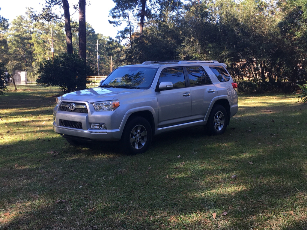

Is it done yet? And pictures?
All done, just waiting on my tires and wheels to arrive now. Here’s a before and after.
