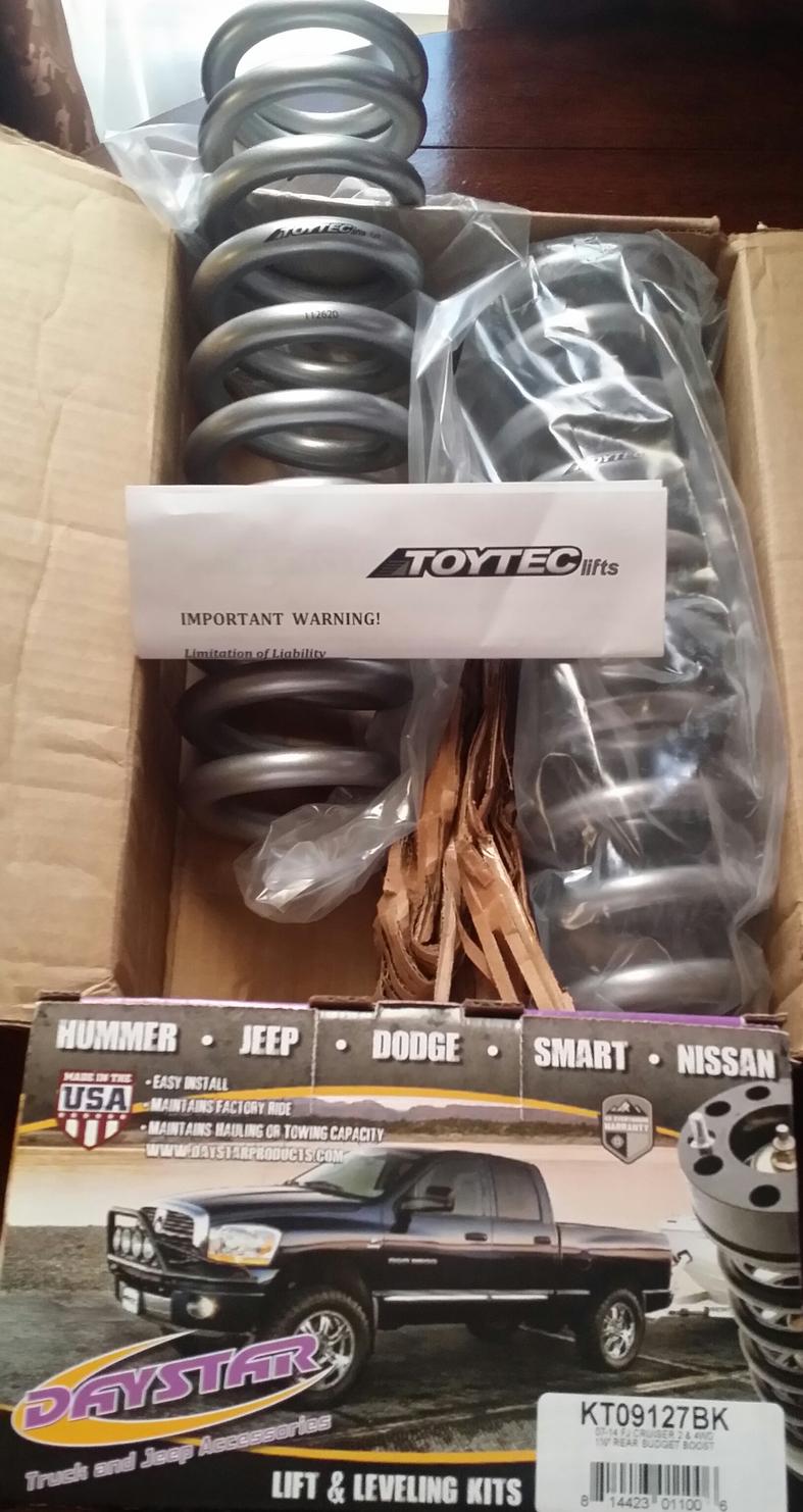

They finally arrived, just have to wait and get it installed.

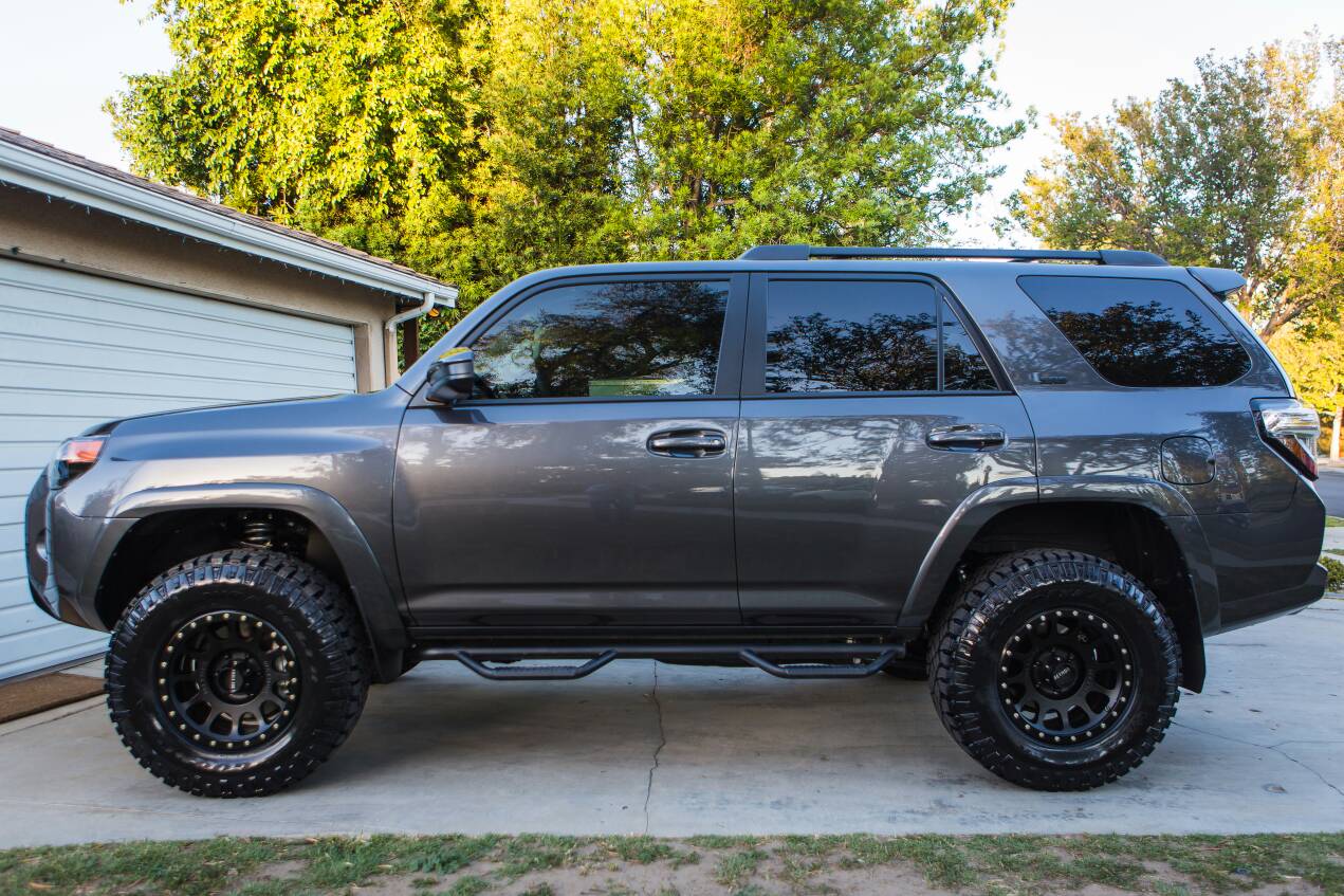

I finally got to install the springs. I did the install all by myself and man it was tough doing it alone. I'm really happy how it turned out and looks the way I hoped it to be. Here's a photo. I used the superflex in the rear and the toytec/eibach in the front with the 2nd notch on the bilstein. Looking forward to seeing how yours turn out.

One word "WOW" love the looks and stance, now im hoping mines turn out the same or close to what yours look like. Got the parts in, now just have to wait for my install date .
Thanks bro. Yeah I'm pretty happy with it. Keep me posted wanna see yours once it's all done.
