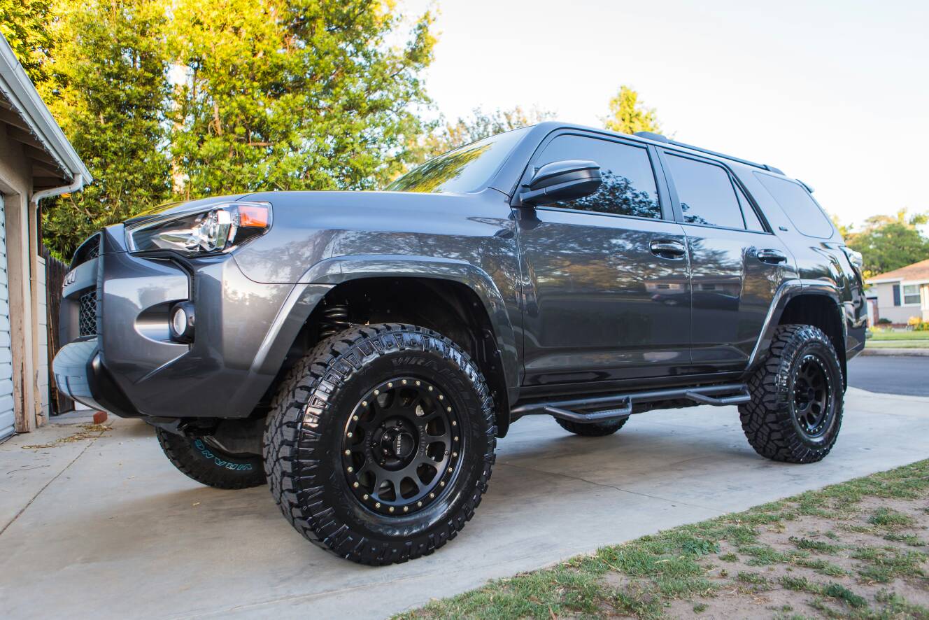

I finally got to install the springs. I did the install all by myself and man it was tough doing it alone. I'm really happy how it turned out and looks the way I hoped it to be. Here's a photo. I used the superflex in the rear and the toytec/eibach in the front with the 2nd notch on the bilstein. Looking forward to seeing how yours turn out.

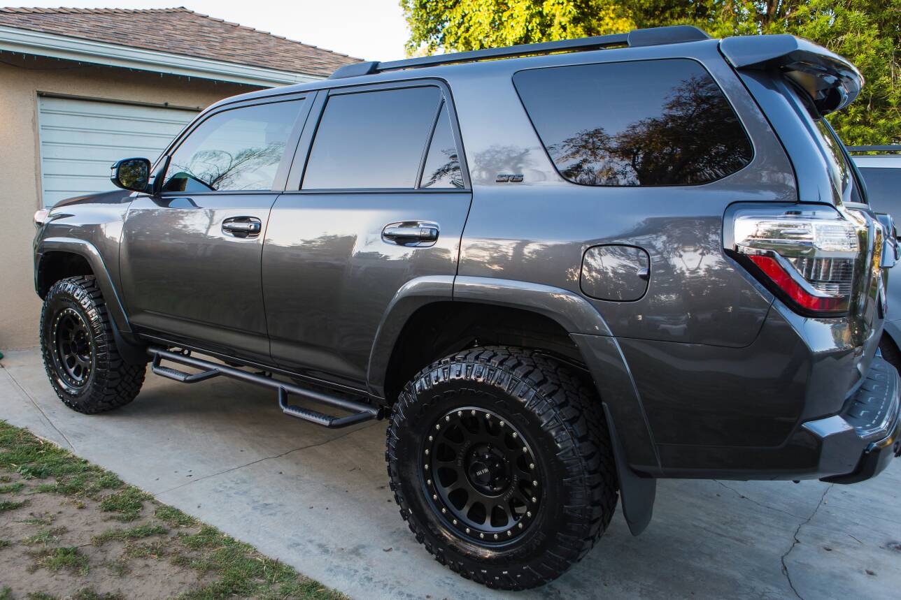

Either way you go, the height on your 4runner looks good. I was originally gonna go with your same whole setup, but took a chance to do the 3/2 lift. I told myself it it didn't look and feel right i was going to switch it out lol. Came out the way i hoped it would. Ill see how it settles after a while to see if it drops down a little bit. Skids and a different slider are on my wishlist as well. Just using the Nfabs for the kids and the wife to get in and out for now. once the kids are big enough its coming off lol.
Front view/rear view

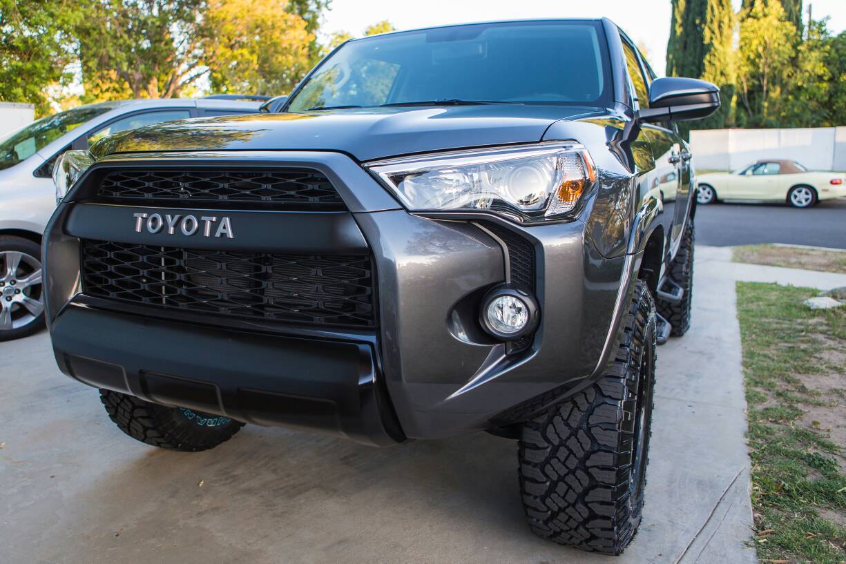

Elev8te:
Can you post a pick from the front and rear views of your rig? Would like to see how much your tires extend. Looks awesome man.
Elev8te:
This is all I have for now I can take more tomorrow with better angles.
