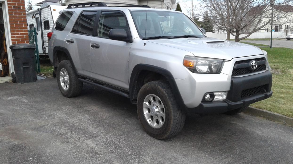

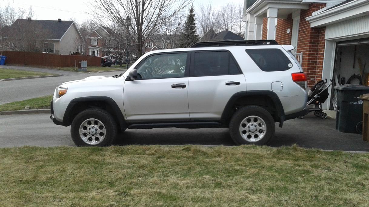

5100 on setting 0, with Toytec 112620 in front and 5100 with Toytec Superflex for the rear. I've got about 2.5in of lift on each corner and kept the front rake. I've also replaced the worn out bushings of the stabilizer bars, which make the truck behave way better and no more clunk.
Can i ask what is your ground to fender measurements?

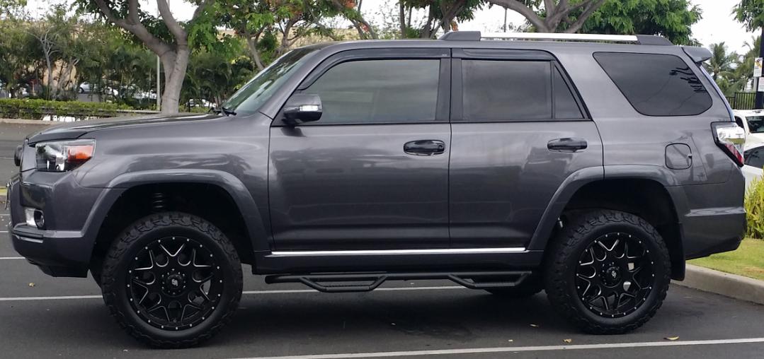

Bilstein 5100s all around Toytec 112620 front coils along with 1/4 toytec spacer on the driver side & Toytec 2" superflex rear coils.

spring compression?
