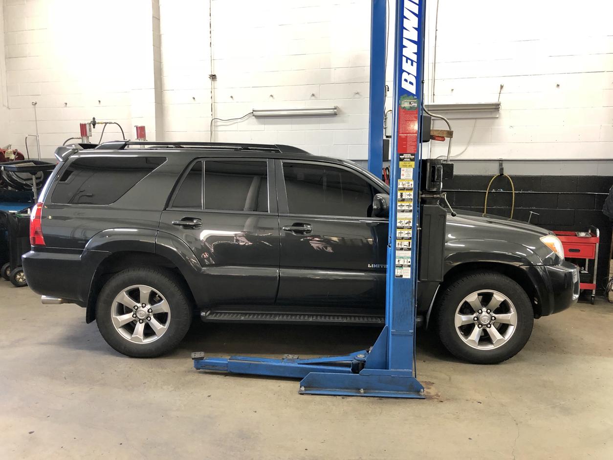

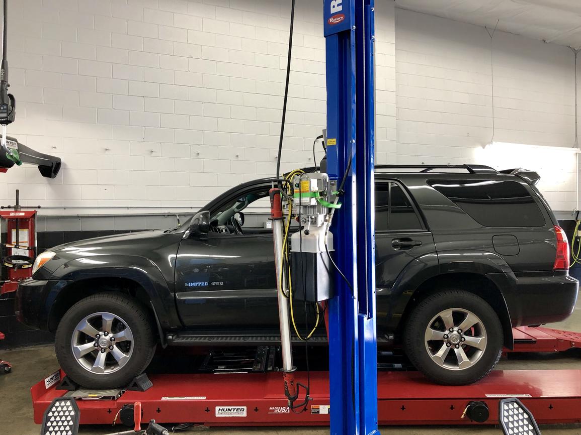

Just wanted to post an update after installing 5100's front and rear shocks with stock springs. 2008 V8 4x4 here with 110k miles. 5100's set to 1.75" in front. Completely removed the x-reas system and lines (what a mess!).
Measurements from ground to fender (at center of wheel)
Before:
LF 33.25" RF 33"
LR 35.75" RR 36"
After (approx 50miles of driving):
LF 35" RF 35"
LR 35.2" RR 36"
Gain of 2” in front and 0 in rear. Pretty much as expected. The truck is pretty much level at this point however I’m wondering after loading cargo/camping gear etc I may end up with a negative rake (don’t want). We’ll see!
NOTES:
Interesting to see the LR at a lower height - maybe fuel load difference? Alignment came out perfectly with nothing out of specs after. No rubbing issues at this time with 265-65-18 Limited wheels. Overall impression of the 5100's is good. With using the stock springs the ride hasn't drastically changed (which is perfect for me). I notice less body roll in cornering and less nose dive under braking.

Looks really good!

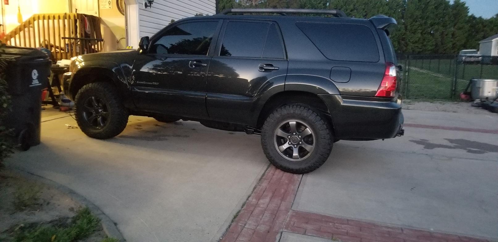

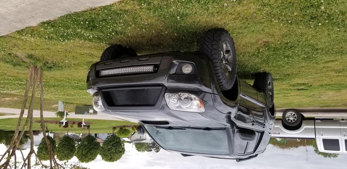

I have mine at 1.75 and mine looks like it needs new springs. It still has too much rake for my liking.
