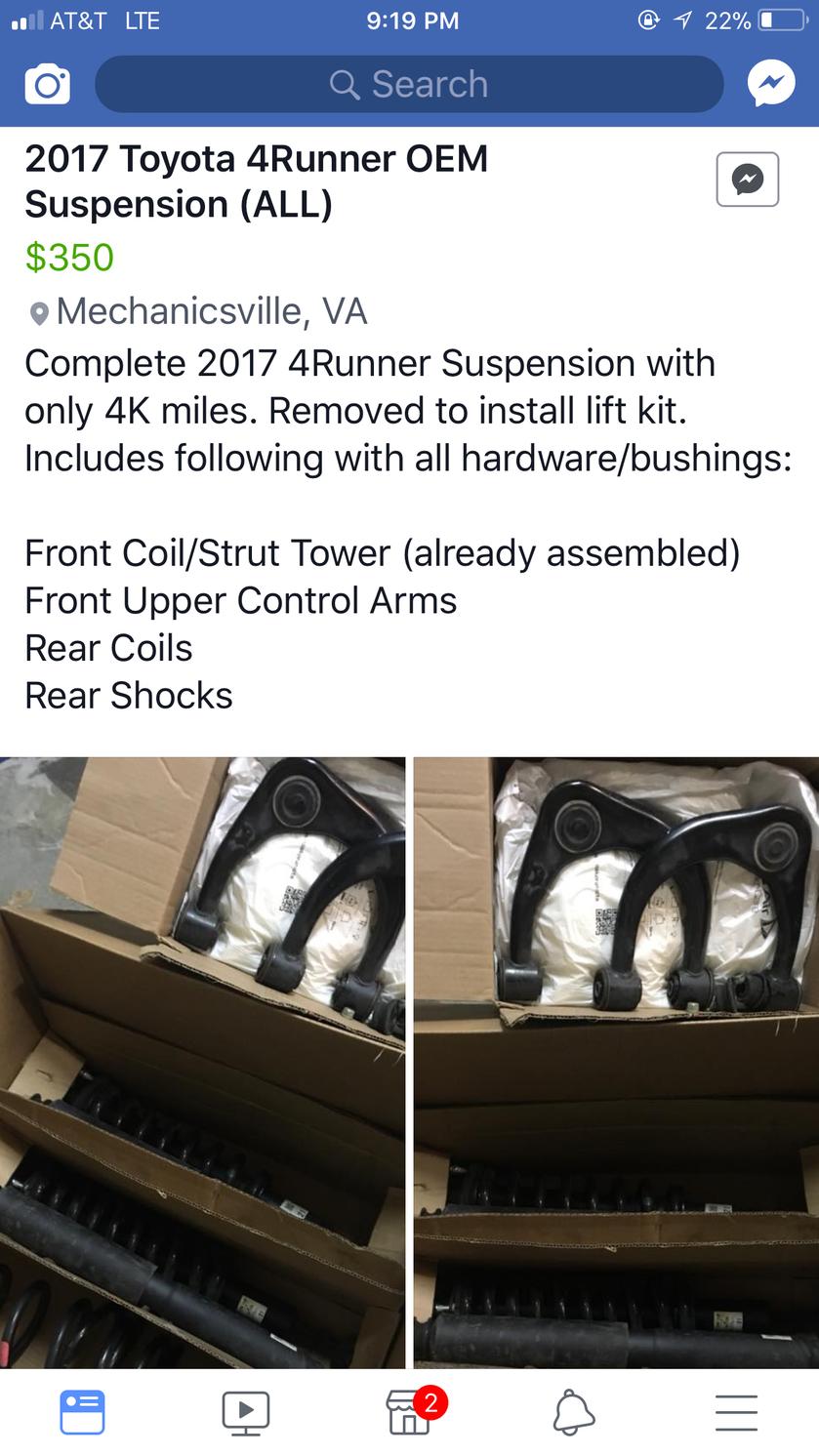

Thanks... seems like there are no aftermarket springs that don't add some height, so I might just buy some stock OEM coils from a dealer that will at least not have 100K mile of sag on them.
Just saw this in Facebook
