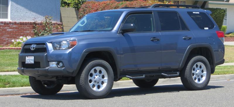

Mine has 0.85 in front and no spacers in the rear but air bags when needed. At minimum pressure in the bags it sets a little higher in the rear.
