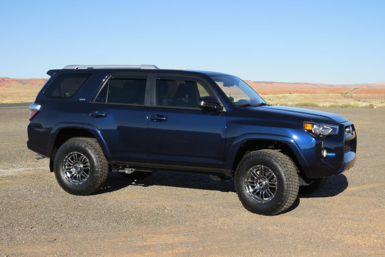

I ended up a little nose high, so I installed two OME 10mm shims on each side when I put in the CoilRite airbag kit. A little extra air on left eliminates the lean.
Oops - I need new tires. 285s on 0mm offset rims. I love the look, and chicks now dig me.
Judge for yourself.
