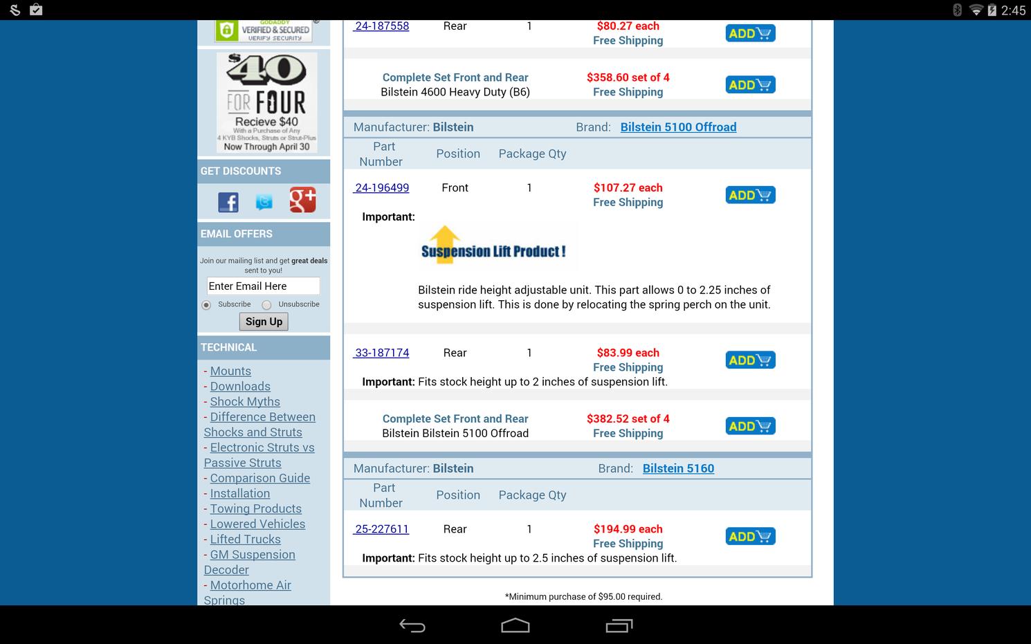

5160
Shockwarehouse.com shows stock too.
Shock warehouse does not have the 5160. I talked to them already. I heard that they are not supplying them anymore because toyota is supposedly buying all of them for the new trd 4runner. But I have been told that they take more maintenance which i am not excited about so I will investigate the 5100 more. Thanks
