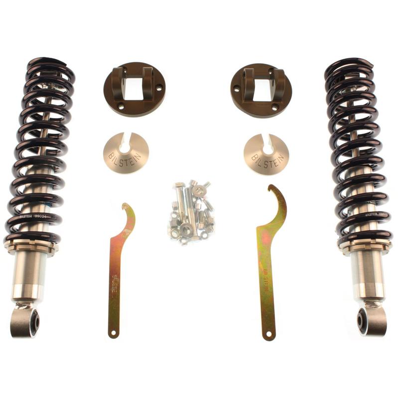

Is anyone out there running this system?
This site has it listed with a parts number, but Bilstein's own site does not list a part number yet.
*representative photo*
It appears to be similar, if not the same, to the TRD Pro setup.
Any input welcome.
several other online vendors have had those listed as "in stock" since this summer, but I called Bilstein back then and was told October/November before they would even start distributing them. They also have them listed to fit a 2011-13 - no reason for omitting the 2010 model.

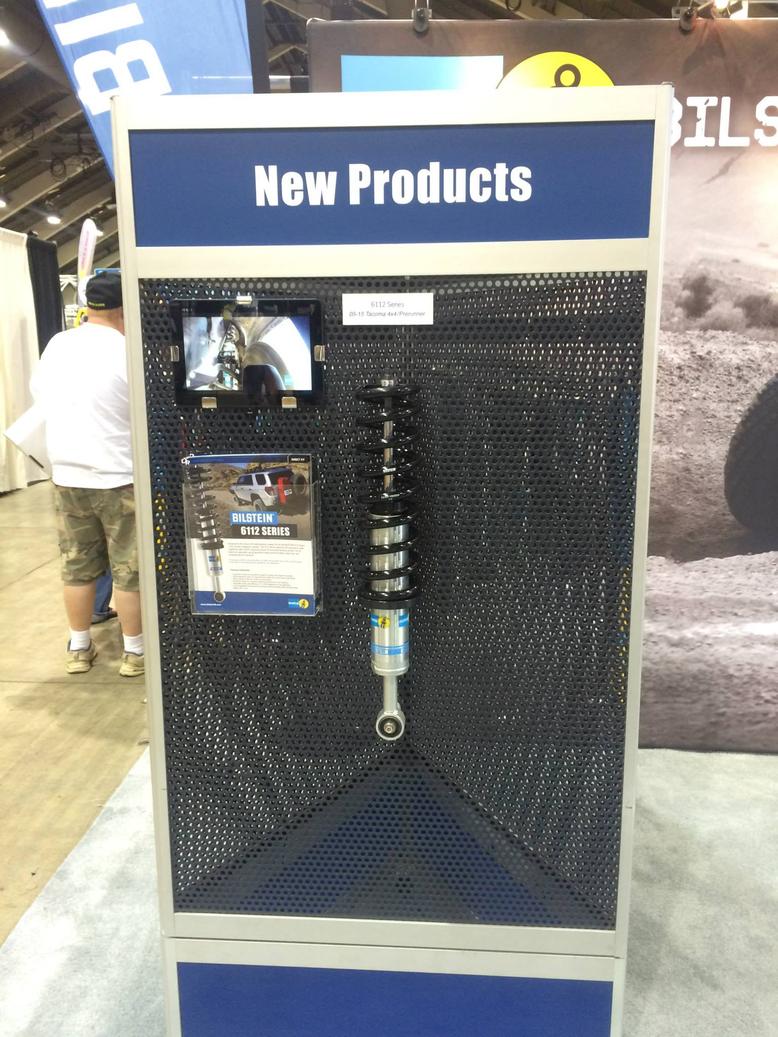

Yes, 60mm to be exact (~2.36 in). They already have a setup for some trucks available. The FJ/4Runner/Tacoma is next according to the rep. They showed off some near final production units at the recent Off-Road Expo.

The 60mm bodies are nice, but what valving is going in these? What is the advantage over the 5100, aside from continuous adjustment from 0-2.25" (opposed to preset perch intervals) and slightly improved cooling characteristics?

I was told last year at SEMA that these (just like what is on the TRDP) will have a softer spring rate but more aggressive valving in the shock itself. Supposedly, designed for flying down a trail but good everywhere else too. None of the reps would comment on how a winch and aftermarket bumper would affect the BTS though. At least they are adjustable though.
I did a little more digging...these will apparently have digressive valving and will come paired with Eibach springs....I may just eat my words after all....
