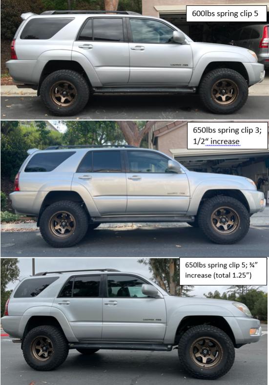

Ride was much approved over and more controlled. The 600lbs seemed more soft and mushy like a stock spring but lifted. I have about 2.7" lift and clips are set at 5 of 6 (5th clip on top) on both sides. I don't have armor in the front but again I wished for maybe at least an 1/4" of lift. Ride is good but front is still raked. I attached a picture.
Mike
Mike
Thanks for the pics, Mike. It looks great!
