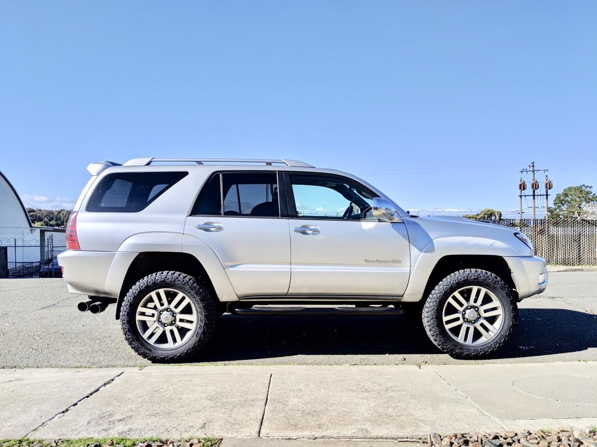

I just order some eibach 700lb 14” springs for my 2005 v8 4wd sport edition. Just put on some 33” rubber on the 5th gen 20”s. With the bilstein 6112’s I have on now I am using max height adjust on both clips and also driver side: 1/2inch spacer, passenger side 1/4inch spacers. To compensate for driver side lean I think I have achieved around 3” lift up front but I desire a bit more, I don’t want completely level but a very subtle rake effect. We’ll see how these 700lb springs help :). In rear I have bilstein 5160’s ome 2895 2.5-3.0 lift and the rake is very high compared to front. I don’t really drive the car loaded with much weight and I hope ride quality is still good but if it’s stiff I won’t really mind to be honest :)
Will post results in about a week once Installed. Current photo
