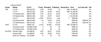

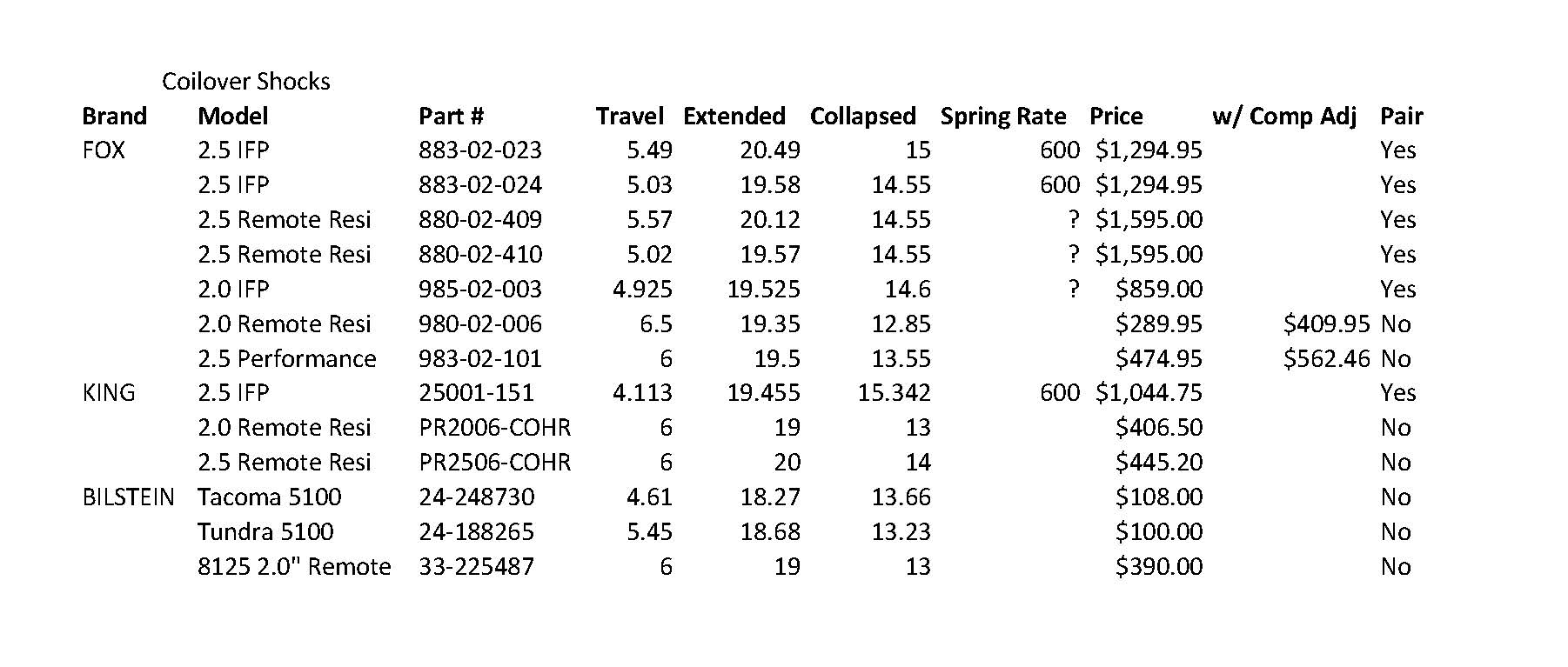

Decided to compile all the info I have collected into one sheet that I have attached to make it easier to read. Hope this helps anyone looking to make a decision on purchasing new shocks or coilovers. If anyone has any info to add feel free to post it up.
Thanks for creating that pdf. Good info
