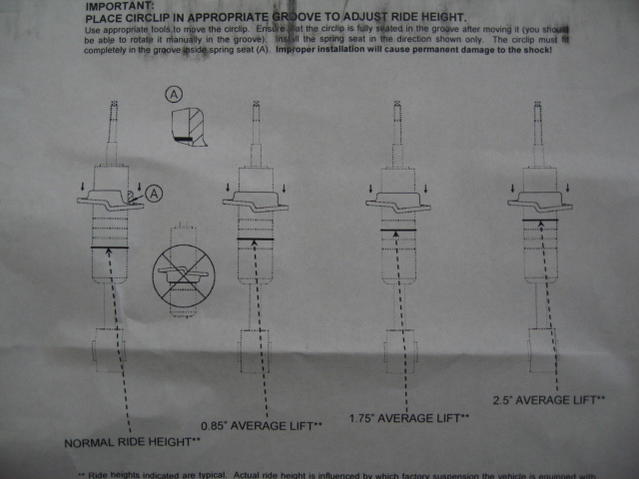

The instruction sheet for adjustment on the 5100's shows 4 settings. The bottom position is labeled as Normal, as in zero lift. I'm leaning towards setting mine at the 1.75 and also planning to install a air bag to assist rear sag when I am loaded down.

Yep, as it shows above the 5100s do have four settings. We'll need to double check, but I sure do think yours is on the .85 based on the lift amount you got.
The lowest setting the 5100's go is the .85" I thought? The lowest place for the c-clip is on the .85" setting, so you can't put them on "zero" setting...at least that's what I thought. Anyone else verify that??? the c-clip has to be in place, and I'm 100% sure there are three options as already mentioned, just not a bottom or "lowest". The .85" will be more or less stock.
No, 4 settings. 0.85" is not stock height -- it's roughly 0.85" taller, maybe a little more.
